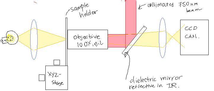

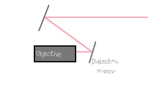

Here is the sketch of the setup (the imaging part)... apart from it I have 2 lenses that expand the beam and another mirror to move the beam.
The wavelength of the laser I use is 750 nm, the dielectric mirror reflects most of it, but let's some through so I can still observe it on the CCD screen, when it is reflected off the slide.

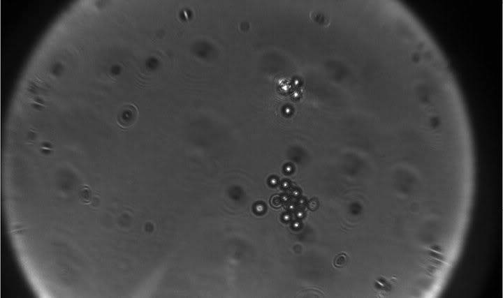

I can get clear pictures of the spheres and the beam separately, but not both... And i want to know how to make the planes of the laser focus and the plane of the microscope focus coincide?

From what I understand, you are trapping spheres (plastic?) in a fluid solution, and you want to simultaneously image the trapped sphere and the trapping beam. You are currently able to image one or the other, but not both.
On the systems I've built, if I bring the focus of the trap into coincidence with the focal plane of the image (by, for example, imaging both the coverslip and the backscattered laser light), then the trapped particle is not in focus.
But the only reason I need to image the laser is for alignment- once the tweezers are aligned to the microscope, I don't image the beam anymore- so I'm a little confused by your question. I'm not interested in the laser focus being in the object plane, I'm interested in the trapped object being held at the object plane.
In any case, if you want to adjust the axial position of the beam focus, you can 'detune' the beam expander to add a bit of divergence (or convergence) to the trapping beam prior to it entering the objective- if you are using an infinity corrected objective lens, this won't add too much aberration to the trapping beam. But, if your optics are misaligned, you can introduce a lot of off-axis aberrations which will rapidly deteriorate the quality of the trap.
Does this help?

Yes. Look at the reflected beam at 45° angle of incidence. If the reflector is on the back side then you'll see two extra reflected beams from the front surface, weaker than the main beam but noticeable, one on either side of the main reflected beam.
If the reflector is on the front side, you shouldn't see the two extra reflected beams ... but if you do see extra beams, they'll all be on the same side of the main reflected beam.

One bit of advice on alignment technique- *always* align to the laser beam. Assuming you are not using a microscope, the alignment steps proceed: shine beam directly onto the sample, then place lens #1 in the path, center and adjust tip/tilt. Then add lens #2, repeat the alignment steps, the add the microscope objective. Once that has all be done, perform final alignment by imaging the focused laser (I replace the samples with a mirror) and adjust first the objective, then lens #2, then lens #1 to minimize the various aberrations.
If you are using a microscope, then first align the beam to the microscope optical axis, then proceed as above. If there are mirrors, align them all prior to adding any lenses. I perform my final alignment by adjusting the mirror tip/tilt, rather than the lenses.

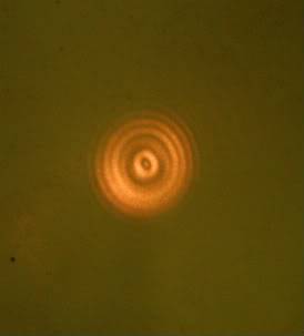

I guess, after all this discussion, I am wondering why the Airy pattern was present at the focus of lens #1 in the first place: can you reproduce the original setup and verify that?
I think the pattern was viewed after the focus, not at it? From Post #7:
kubikat said:
After the focal point of the first lens, the pattern was produced

Also I have one other question: Do you think it matters much that my 45 degree dielectric mirror is not at 45 degrees? This way I get more of the image of the sample of the screen and also am able to see the ray reflected off the slide cover on my CCD camera (since some of it is transmitted)
Here is an image to show what I mean.

Oh yes and the pattern was viewed after the focus (it might have been there before, just was too tiny to see)
And I did figure out the mirror had nothing to do with the pattern :D it was all in the path length difference... Thank you ! I still don't know why the path length difference matters so much but it's nice to narrow it down :)

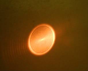

I'm not even sure where to start... Dielectric mirrors are almost always designed to reflect a given wavelength having a particular polarization at a particular angle of incidence. Going off-nominal will always decrease the reflected power.
If your laser is not single mode, you will *never* see an Airy pattern. Honestly, I am convinced that the only way to get a stable 3D trap is to use a single mode beam. If all you are doing is pushing particles against a glass surface, then yes- a crappy beam will still give you some decent 2-D confinement. But for a full 3D trap, you simply must have steep intensity gradients, and this will only be possible with a single-mode beam.
At this point, I'll await some images of your setup, beam spot, etc. Maybe it's worth sharing some images of my current setup?

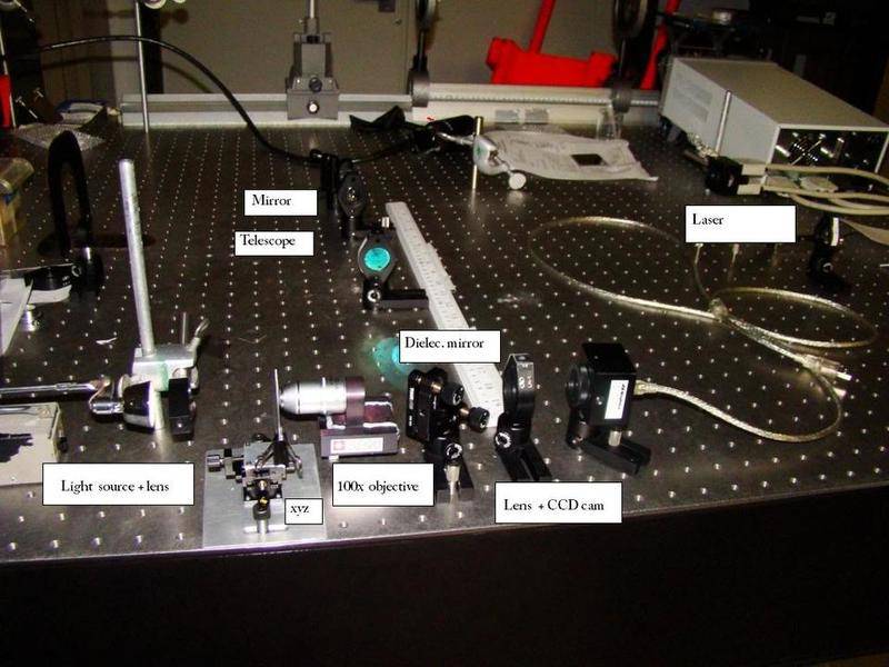

My setup is very simple ( it is inexpensive for one and then my professor wants me to set it up and write a manual so students in the advanced physics course would be able to set it up themselves --- so it has to be simple). It is all in one plane - horizontal. I personally think that the vertical would work better, but horizontal is simpler and more safe (the beam never leaves the plane of the table). In any case if you could post the images of your setup that would be awesome. I will post mine in a few posts after this one.

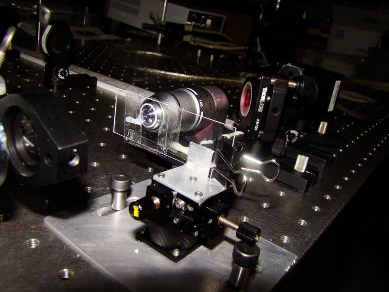

Here is the image of my whole setup. I am using a diode laser. 100x oil immersion objective and the telescope lenses I currently use are 50mm and 250mm focal length.
And here is where I am trying to trap them. I am planning on making sort of a flow cell once I can actually trap something to measure how strong the trap is.
And here is the beam pattern that I see when beam comes out of the laser and hits the first lens after the focal point (this one is when the path length of the beam is rather short). I am not sure why I get the rings.
Here is how the beam profile changes as it travels longer distances. At certain distance I can make the "hole" in the center disappear and then the center of the beam seems to be gaussian.
Thank you a lot for your help. I know it is a lot of work looking over this kind of stuff. And Andy, the images of your setup would certainly help. Also if you could please send me your paper on the optical tweezers from space station. ( I am not sure if that is an appropriate request, since I tried downloading it online but every website I visited required me to pay for it.) My school library might have it, so if you are not able to send it to me, I should be able to get it there. Thank you again!
Also I am sorry the pictures of the beam are so huge. I tried making them smaller on the host website and then add them in here again. but they wouldn't change
This is making more sense now, I'm pretty sure this is a basic diffraction effect.
It looks like part of the circularization process built into the laser is to send the beam through a circular aperture. At shorter distances, the beam looks pretty much like the aperture, though rings are present to some extent. At longer distances, the diffraction effects become more pronounced, with the center going through bright and (nearly) completely dark regions.
Oh okay, so that's just diffraction? I do send a beam through a small circular lens that I put into the diode module for collimation. Where shall I keep the telescope then? At the position that gives me a more pronounced diffraction pattern (far away from the laser) or near the laser where I get the ring pattern? I think further away would work better since the central maximum is (should be) Gaussian. But I am not sure.
These pictures were very helpful. I'm taking a mental health day today, I'll be able to take some images and send you the PDF file tomorrow.

Before I get to these images, here's two photos of my setup:
[PLAIN]http://img585.imageshack.us/img585/3264/dsc01324u.jpg
[PLAIN]http://img691.imageshack.us/img691/5079/dsc3306.jpg
The tweezers are coupled into an upright microscope that uses infinity-corrected objectives, so the beam coming out of the tweezer module is (nearly) collimated. The top view of the module has the following components (in order): Nd:YAG laser, mirror, 40 mm plano-convex lens, mirror, 250 mm plano-convex lens. Inside the microscope there's another mirror, directing the beam down into the objective lens. the tweezer module sits on top of a 4-axis positioner (x, z, tip, tilt) that allows me to bring the tweezer beam into alignment with the optic axis of the microscope.
Here's an image of the spot at the sample plane:
[PLAIN]http://img707.imageshack.us/img707/1190/flycap0.jpg
and slightly defocused:
[PLAIN]http://img574.imageshack.us/img574/7902/flycap1.jpg
For these images, I used a 100x NA 0.9 objective- I generally trap with a 63X 0.9 dipping objective, tho. The two small dots/interference fringes are caused by the mirror in the microscope, and are not actually present at the sample, AFAIK.
Your beam images look ok, there's perhaps a hint of astigmatism (the spots are not perfectly symmetric, there appears to be a feature at about 45 degrees on one image). This can be minimized by tip/tilt adjustments of your lens. At the trap, astigmatism will manifest by a jet of particles shooting off to one side.
I'm not seeing any evidence that your laser is multimode- can you take some images of the focused spot? Put a mirror in place of the sample (lay a coverslip on top of the mirror if your objective requires one), and take a picture of the reflected spot.
Can you make a trap?

Hi Andy! Thank you a lot for your pictures. They were really helpful, since now I had a better idea of what I was looking for, looking at the beam. I finally got trapping! It was really really exciting. The trap was very strong and kept literally sucking in the particles from within of like 30-50 micrometers. My friend and I decided it looked like a gravitational potential well except in optics. I was able to move the particles around as well. The weird thing is though, I got trapping when I only had one of the telescope lenses in (the one with the large wavelength) so the beam wasn't even close to filling up the back aperture. I put the other lens in afterwards and it seemed to have made the trap less strong, but I still need to play around with it some more.
Here is the image of the trapped spheres:
I am so happy it finally worked. Do you think it looks okay?

Oh and the cluster of the particles on the bottom is where a beam used to be before I moved it. I can also use the beam to grab particles one by one and arrange them in shapes.
  • #34
Excellent- glad to hear it!
In response to your questions, here's my best guess:
1) You do not have a 3-D trap, you are pushing particles against the glass, where they stick due to electrostatic interactions. This may or may not be a problem, depending on your goal.
2) The optical trap does indeed share common characteristics with a gravitational well- the trapping energy is approximately a quadratic potential well, and dielectric particles 'fall' into it.
3) Your objective lens is not infinity-corrected, so the trap beam should not be collimated when it enters the objective. My suspicion is that you are focusing the trap beam with the singlet when the trap is optimized. If you want to fill the back aperture (which results in a 'stronger' trap) while still trapping objects in the focal plane, you need to adjust a few aspects of the telescope. It can get involved since the objective is not infinity corrected, and I'm not sure I can easily walk you through it- and I've never done it.
My design was based on this:
http://www.opticsinfobase.org/abstract.cfm?URI=ao-36-10-2107
and you may be able to get some ideas as well, especially from page 2109.
