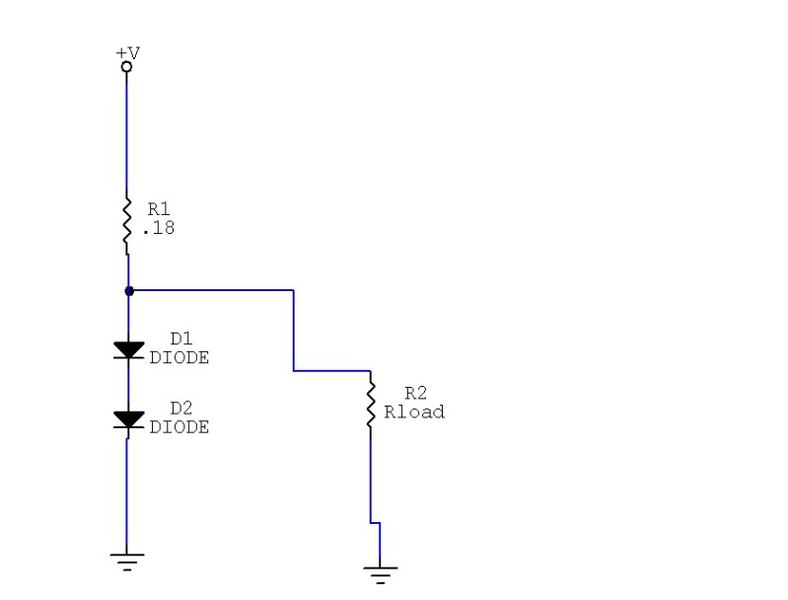

Design a diode voltage regulator to supply 1.5 V to a 150 Ohm load. Use two diodes specified to have a 0.7 V drop at a current of 10 mA. The diodes are to be connected to a +5V battery and a resistor R. Specify the value for R. What is the diode current with the load connected?
I'm assuming that we determine R with merely the voltage source, resistor R, and the 2 diodes in series.
Thus, R=(+5V-1.4V)/10mA=360 Ohms
However, this puts the output voltage at 1.4 V
Thus, after this point, we attach the load resistor in parallel to the network and the voltage across it will be 1.5V as desired.
The load resistor will draw a current I=1.5V/150=10mA, thus the current through the diode is decreased by this much and thus I=0 when attached to the load.
Does that seem right?

First, the current thru the load has to be 1.5V/150 ohms = 10 mA, right?
What if you string the two diodes in series from the 5V supply, then what would you have to do to get 1.5V across your 150 ohm load?
I was under the impression that diodes were placed in parallel to the voltage source when used as regulators. At least any of the examples in my textbook use them in that manner.
Okay, I think I may have an idea. If the load resistor requires 10mA to give a 1.5V drop, and the diodes also require a total of 10mA to provide ~1.5V drop, then the source current would be 20mA total and thus the resistance R=175.
I think we're in a semantics trouble-zone here.
You certainly can't put diodes in parallel with a voltage source. You would burn out the diodes in a jiffy!
Can you draw your proposed diagram, scan it into a PDF and attach it, or use some other app?

Well, you didn't make 1.5V across your load, did you? You fell 0.1V short.
Plus, your diode current is close to 5V/0.18 ohms = 28A which is a PRETTY big amount of current thru those poor little diodes.
Do this please: connect your diodes in series as they are now, except connect the anode to the 5V supply's + end, the connect a resistor R from the diodes' cathode end and connect the other end of R to your load. Complete the circuit by connecting the other (low) side of your 150 ohm load to the 5V - terminal. Call this terminal zero volts.
Now, how would you calculate R such that i = 10mA? Would i = 10mA satisfy the requirement for the load voltage (+1.5000V)? Would the diode current be close to the level at which the diode drop (0.7V) is specified?

When I did as you told me to, I got R=210. However, disconnecting the load doesn't increase the output voltage, it stays constant at 1.5 V.
Then you didn't wire up as I suggested.
You got the value of R right. When you remove the load, the output voltage will be 5V. That's because without the load, i = 0 so there is no voltage drop possible across either R or the two diodes.
Don't even try to calculate the output voltage for any other condition than i = 10mA or i = 0. That's because you don't know what the voltage drop across the diodes is for a given current. (As a practical matter, that drop will be close to 1.4V for a wide reange of current, say i = 5mA to 50 mA but that depends on the particular diode type.)
