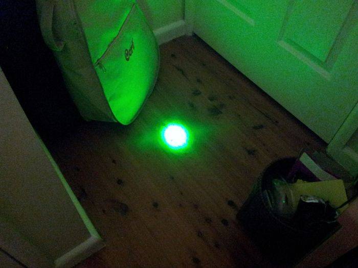

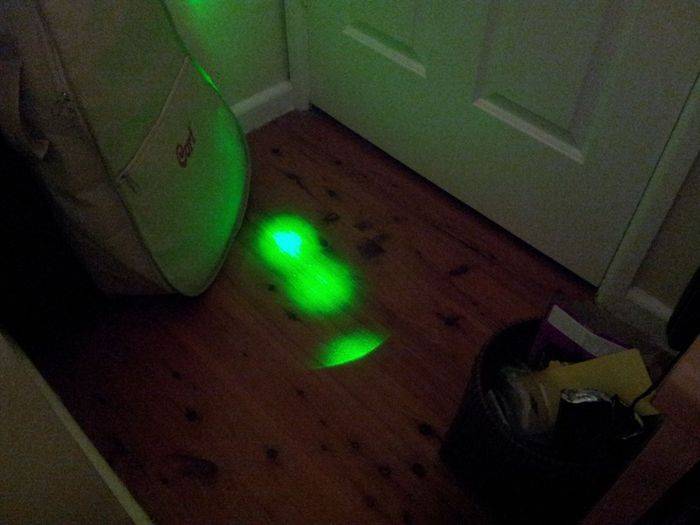

Thanks for the info, Jim. I'll have to keep it in mind for next time however, because it looks like the diode's borked. I took the focusing lens off to see what's going on. When I first turn the laser on, everything is coherent and there is one large blurry green circle under the laser. But about 30sec-1min in, as it warms up, it looks like the circle gets separated in a number of dimmer circles with the same diameter as the center one. It looks like the whole beam becomes out of focus as the cicles are not centered anymore which means the lens can't focus all the circles that are not incident on it, hence the drop in intensity.
Here are some pictures to show you what I mean.
The module:
Before:
30s-1min after laser on
Thoughts?
Are you saying it does okay until it gets warm?
That sounds like it needs its controller board, or something similar, to limit input power.
Picture of the module doesn't show (windows, ie10)

Yes. It seems that it doesn't matter if I run it off batteries or adapter, it still does it after a while.
