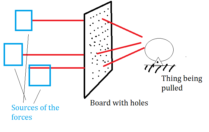

Hey guys,
I'm looking for examples of real life systems which uses a board with holes to redirect cables in tension (as opposed to pulleys) for some inspiration on a project I'm working on.
I've attached an schematic of what I mean. I've tried searching google for systems but it's a hard thing to describe accurately. Also any advice as to how to improve on this design is greatly appreciated.
Thanks in advance.
I think you misunderstand the purpose of using pulleys in tension systems. Yes, the direction of the tensile elements can be changed by the placement of the sheave w.r.t. the load and the pulling force, but in many applications, a system of sheaves is used to provide a mechanical advantage, in order to move a large load using a small input force.
It's not clear what your design does except to provide a means to apply several tension forces to a single load. In rigging applications, this is usually accomplished by the use of spreader bars or lifting frames.

True, but if there was nothing to stop a cable rubbing against the holes where it changes direction (as in the OP's diagram), I don't want to fly until somebody redesigns the cable run :eek:
The OP didn't give much detail about the design, but it looks a "good" way to break the cables by frictional wear and/or fatigue, if the position of the bend along the length of the cable keeps changing.

Thanks for the warm welcome and advice guys, and sorry for not making what I'm trying to do clearer.
Basically the board is there to redirect the cable to specific force vectors. The object that's being loaded is being loaded slowly from 0 [N] to x [N] and then held at x [N] statically to measure the resultant force on the object. Also this is a small scale design with cheap, easy to replace cables/sting/rope/etc.
The main issue I am currently having is that some outlier force vectors which require testing are near parallel with the board. That's why I asked for examples to see it there were low friction ways which to redirect cables that aren't pulleys. (because the use of the board with holes is mandatory)
Maybe you can find some short lengths of Teflon tube, (PTFE). The cable will slide in the tube and so pass through the hole in the board with very low friction.
PTFE insulated wire is available, you might use the insulation from that.
