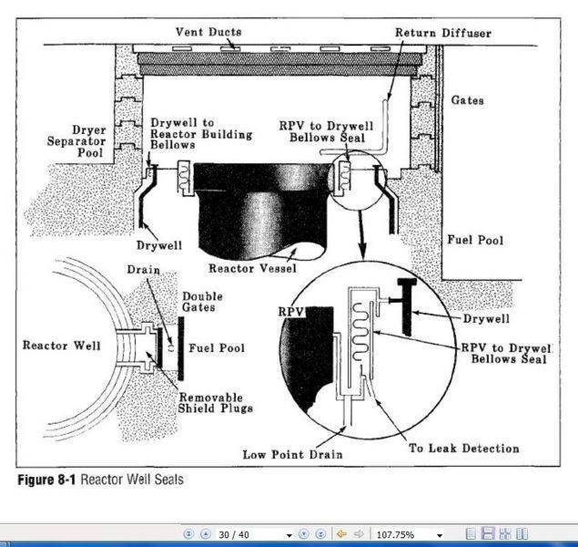

Cs decrease rate and TEPCOs theory of the broken gate to SFP#4
When calculating the leakage rate of the SFP#4 I get these formulas for the leakage rate r:
1. Refill at constant rate:
r1 = V/t*ln(C(t)/C(0))
2. Refill only once:
r2 = V/t*(C/C(0) - 1)
The truth is somewhere in between because TEPCO probably does a refill once or twice a day. But this does not really matter: r1 / r2 = 1.29.
What is more important: there is the volume V of the SFP in the formula. Now, TEPCO said that the gate between the SFP and the RPV has been destroyed. This would increase the effective volume we have to put into these formula.
With V = 1200 m3 we get a leakage rate of ~40m3/day. Adding ~70m3/day evaporation rate we get 110m3/day total loss rate which is consistent with the refill rate published by TEPCO.
But if we have to increase the volume V (I estimate a factor 3) we get much higher rates (120m3/day leakage rate + ~70m3/day evaporation rate = 190 m3/day total loss rate) which are no longer consistent with refill rate published by TEPCO.
