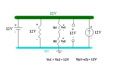

Find [itex]v_0[/itex] in the circuit below and the power dissipated by the controlled source.
http://img291.imageshack.us/img291/5479/chapter2problem22wy5.jpg
KCL
[tex]v\,=\,i\,R[/tex]
KCL: [tex]i\,=\,2\,v_0\,+\,10\,A[/tex]
[tex]v_o\,=\,i\,R[/tex]
[tex]v_o\,=\,\left(2\,v_0\,+\,10\right)\,(4\Omega)[/tex]
[tex]v_0\,=\,8\,v_0\,+\,40[/tex]
[tex]v_0\,=\,-\frac{40}{7}\,V[/tex]
Am I on the right track here?

I believe the question wants you to determine the P = VI for the dependent source. Since you have the I as 2v0, all you need next is to calculate the V across the dependent source and then multiplying the two terms for the power.
Would that V be half of the [itex]v_0[/itex]?
P is 32.7W and not 65.3W?
No Vinny, that V would be the voltage across the VCCS. Equivalently, that is also the voltage across the two resistors, since the (4+6)ohm, 10A source, and VCCS are all in parallel.
The voltage across the VCCS is what I need for the P = v i equation right? It is the v and the i is the current contribution of the VCCS? That would mean [tex]p\,=\,v\,i\,=\,\left(-\frac{20}{7}\right)\,\left[2\,\left(-\frac{40}{7}\right)\right]\,=\,32.7\,W[/tex]
If that is not it, how is it calculated?
As I have earlier said, it will be the V across the (6+4)ohm. Since you have already found the current across the resistors, this V shouldn't be too difficult to find I am sure.

P=IV
you know what the current I is, so multiply it by the voltage ACROSS THE SOURCE. if you need a hint on how to get this, just know that if two or more branches are connected to two of the same nodes (the top node and the bottom node in this case), they have the same voltage drop across them. Look at this diagram if you don't understand what I'm saying
That would be [tex]V_{VCCS}[/tex], right?
Is it just divided equally between the two sources so the voltage across the source is just [tex]\frac{1}{2}\,V_0\,=\,-2.86\,V[/tex]
yes on the first question, no on the second.
look at that diagram again, all the voltage drops/rises are the same...you can apply this to your circuit too...the voltage across the two sources are the same...and infact, the voltage across the two resistors (combined) is the same as these two as well. this fact could prove useful...especially about the part where:
Voltage across the resistors = Voltage across the V.C.C.S
Are you are saying that
[tex]V_0\,=\,V_{VCCS}\,=\,V_{4\,\Omega}\,=\,V_{6\,\Omega}\,=\,V_{10\,A}\,=\,-\frac{40}{7}\,V[/tex]

[tex] V_4ohm + V_6ohm = V_C.S(10amp) = V_V.C.C.S [/tex]
Ok so I'm not good with the fancy looking formulas. lol. if you can solve for one of these...you know the other two as well

  • #33
lol - so we have this
[tex]V_{4\Omega}\,=\,V_0\,=\,-\frac{40}{7}[/tex]
and
[tex]\left(-\frac{40}{7}\right)\,+\,V_{6\Omega}\,=\,V_{V.C.C.S.}\,=\,V_{10\,A}[/tex]
[tex]V_{V.C.C.S.}\,=\,V_{6\Omega}\,-\,\frac{40}{7}[/tex]
How do I get [tex]V_{6\Omega}[/tex] though?
  • #34
you get the voltage across the 6 ohm resistor with non other than ohm's law:
[tex] V_6 = I_6 R_6 [/tex]
  • #35
Cool!
[tex]i\,=\,2\,V_0\,+\,10\,=\,2\,\left(-\frac{40}{7}\right)\,+\,10\,=\,-\frac{10}{7}\,\approx\,-1.43\,A[/tex]
[tex]V_{6\Omega}\,=\,(-1.43\,A)\,(6\Omega)\,=\,-8.57\,V[/tex]
[tex]P_{V.C.C.S.}\,=\,I_{V.C.C.S.}\,V_{V.C.C.S.}\,=\,(-11.43\,A)\,(-8.57\,V)\,=\,97.96\,W[/tex]
