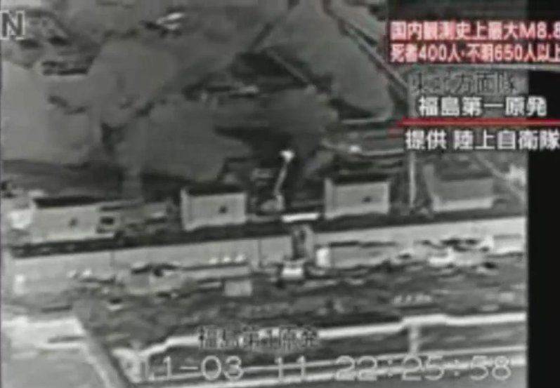

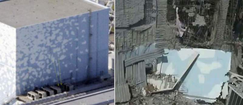

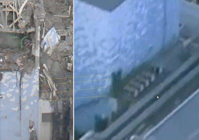

Just watched TEPCO new drone video and was going to post it but quality is so bad its worthless ! Pics to show bad quality ! I hope they have better shots that there not releasing . It does show steam still coming from Unit 3 spent fuel pool and reactor location . Looks like even more . Unit 4 steam or smoke coming from turbine facing side out of blowout in wall if you look close .

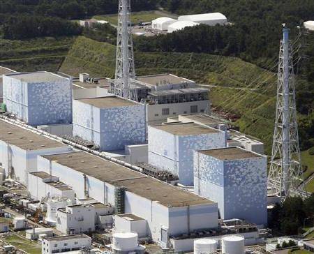

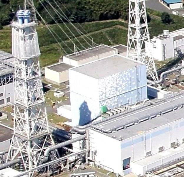

Pic of the tsunami in the plant . Before and after .
That's Daiini, not Daiichi.
Can't agree more! Those drone videos are terrible. Like someone else said, US military totally wating money if that's the best they can do! A 300 dollar RC helicopter with a 200 dollar 12MP digital camera, (suspended on rubber bands for the vibration) and a 32GB sdcard would be far superior!
