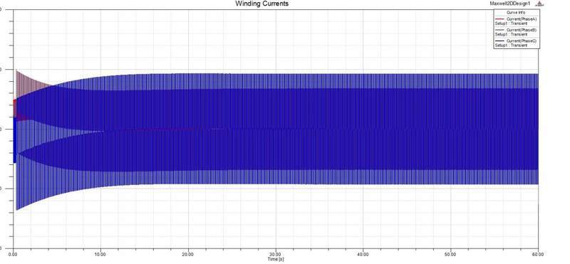

  • #122
Maxwell 2D (ANSOFT)
Hi ..
hope you are all doing good..
i need a help...
currently am working in Ansoft Maxwell,s 2D.
I created a RMXPRT model for 3 phase induction machine. then i exported to MAXWELL2D design.
its a 4-pole 3 phase induction machine. the machine has 60 slots.
it has double layered winding.
the results of the winding currents looks like non-uniform. Phase A, Phase B and Phase C currents are not unique.
kindly give me some suggestions to get uniform winding currents.
Thanks
with Regards
SIVA

Siva: What excitation do you have? Current or voltage source? External circuit?
