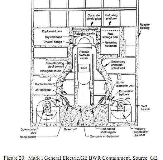

If you look at the elevation of reactor 1, the blueprint that is floating around.
http://www.houseoffoust.com/fukushima/reactorblueprint.jpg
You see that the SFP is tied into the outside of the containment concrete. It hangs sort of like a window box off of the containment structure. There is a very thin piece of concrete that ties the bottom of the SFP to the outer frame of the building. There is nothing supporting the SFP from below.
The technicians at the plant are citing the instabilities of the structure as a whole as causing worry about the SFP stability. From what I was told by a reliable source in the media is that this is a considerable worry, getting some sort of reinforcement under the SFP is a priority. This was before the building began leaning over.

The SFP is somewhat dependent on the building framework. The building instability concerns cited to the media by staff at the plant were that the instability of the building framework is causing concerns about the stability of the SFP.
hmm but did it really begin leaning over?

If you look at the elevation of reactor 1, the blueprint that is floating around. http://www.houseoffoust.com/fukushima/reactorblueprint.jpg
There is no doubt that it is a concern, which is why they intend to do something about it.
However, I am really not sure I agree with your description that the pool would not have anything supporting it from below. That could be the case at 4 now due to building damage, but under normal circumstances it looks like there are a variety of other parts of the structure that hold the pool in place, not just the outside wall. Personally I would not use reactor 1 sketch as a guide, but if I do then I see concrete walls below the pool.
The SFP does NOT "hang sort of like a window box off of the containment structure." The drawing shows a cross-section of the plant at one plane. The interpretation given (from someone who apparently does not have the appropriate technical background to make a sound judgement) is grossly incorrect. However, there is concern regarding the containment structures of Fukushima units following the earthquake (and subsequent explosions), because they haven't been able to inspect for damage, which could be cracks/leaks.

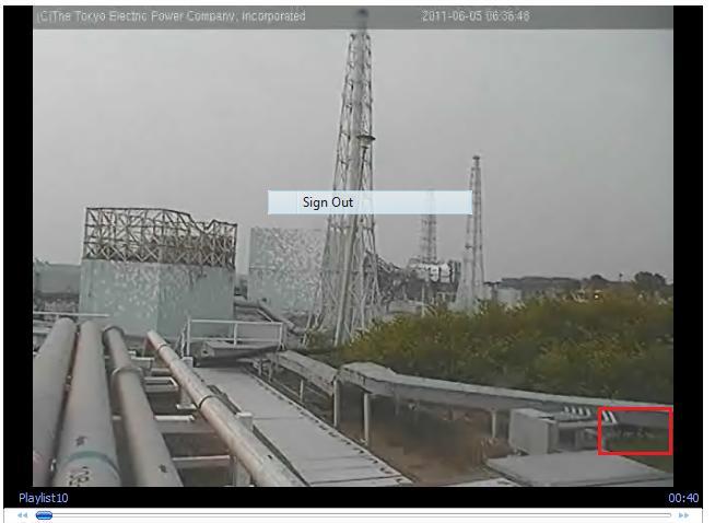

Actually I've just been reviewing the live feed again and I would bet strongly that unit 4 is not leaning, there is simply no indication of leaning at all. If you insist on sticking to the idea that it is leaning, without further proof, please at least ask your 'sources' when this is supposed to have happened, what date did this supposed deterioration to unit 4 happen?

I have a couple of new images on my website. One of the crane being moved and inserted into the side of the building at the work floor level. Not sure why. Move due to structural worries? Moved so work to shore up the SFP could begin? Needed to inject water directly in the pool?
Also some new images of the leaning reactor 4 along with vertical landmarks to try to figure out the leaning. I mentioned in another post that I received confirmation from the TBS tech crew that it is not an optical illusion of the camera and also from workers at the plant that 4 is leaning over. There is also a building on the seaside side of 4 that connects to the turbine building. This could be impacting the way and how much 4 leans over. There is considerable damage to the walls on the north and south so the other two walls have lost some of their ability to stay upright. The containment concrete is built before the building top but it is slightly offset so the weight of the containment structure weight could be causing some of the sinking and leaning. They have poured in tons of water, the soil around the building could be becoming unstable adding to the sinking. There were previous concerns about the groundwater levels making the NPP buoyant. There was also some concerns about the offset reactor design and tall skinny upper building in the context of the two older reactors at Hamaoka that are identical to the older units at FUKU. The tall skinny buildings along with the offset reactors were cited as increasing the lateral movement of the building. This article talks about the superiority in the design used at the newer units at Hamaoka. I am still trying to find the other article on their site that mentioned the lateral issues with the old units. I lost the link, will post if I find it again. http://www.chuden.co.jp/english/initiatives/eini_nuclearpower/enuc_earthquakemeasures/eear_reactorbuildings/index.html
A number of different people who work in various capacities on a daily basis with blueprints and structural issues found it concerning. Of course there is information missing with only having these two elevation views. There appears to be limited reinforcement under the SFP and the people working at the plant are citing structural issues with the pool and the building.
I don't find taking personal swipes at people very useful to the conversation.

  • #6,191
Do you think that they insert the crane into the side of the building because the building is unstable and it its easier to get the crane into this hole without disturbing anything?
Take a 320 pixel wide picture of a several meters structure, upsample that 1280 pixel and draw 2 pixels wide "reference" ..
http://k.min.us/ileBnu.JPG
Edit by Borek: too wide image replaced by link
edit: ok pictures scaled down
[PLAIN]http://k.min.us/jnvlFs.JPG
[PLAIN]http://k.min.us/jle5bk.jpg

I think that they move crane to take video of SFP or/and inside building from new point.
