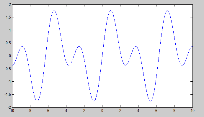

I don't think you can get some universal answer for this, because your sum is a new function which is not a simple sinusoid anymore, although it is periodic. So it doesn't make sense to speak of an amplitude or a phase shift, at least not in the same sense as in with pure sinusoids.
This is your function (y = sinx + sin2x)

Yeah, that's what I was trying to get HIM to do. How's he going to learn if you do it for him?
If you want to have a bit of fun, try adding sin(x) + sin(2x)/2 + sin(3x)/3 and so on, and see what shape you get.

Ah, sorry, didn't realize you were trying to educate him that way. Let's hope he'll still learn, tho.
