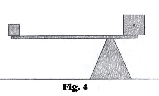

Here is my answer :
I think you are confusing principle of lever with law of conservation of energy.
http://www.astarmathsandphysics.com/o_level_physics_notes/o_level_physics_notes_moments_the_lever_principle_html_210ae596.gif
Now see , in above image that lever is balanced at fulcrum with distance d > distance D
Now since lever is balanced , then anticlockwise moments equals clockwise moments.
Then ,
w*d = W*D
since w<W and d>D
Then
W/w = d/D
Now see that resultant force will act on the point which divides the ratio of distance "d+D" in d:D.
As we know that d> D so the resultant force will dominate at the side of distance d.
Hint : Here centre of gravity will be at midpoint of distance "d+D" that is at the side left of fulcrum in this system ! Also think about section formula of coordinate geometry.
W/w = mechanical advantage as well
M.A. = d/D
Hence the mechanical advantage will be with the small stone of weight w.
Does this help ?:smile:
Edit : Tiny-Tim thought that you were asking about law of conservation of energy in which work input equals work output. That's different matter although here it applies as its a universal law. Halls Of Ivy too answered your question in different way. jambaugh too had a great explanation.

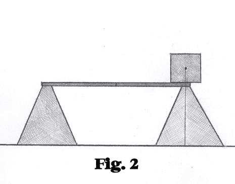

Here is my answer ( please correct if wrong) :
We know that centre of gravity is the point where total weight of body is supposed to act.
Let one arm of lever be longer and other be shorter. Then its quite obvious that total weight downward equals sum total of weight of all the atoms downward. So if one side arm is greater than other , then at that side already there are more atoms and hence greater downward weight. So we apply less additional weight for the both side to be in equilibrium.
Also centre of gravity will be at midpoint of lever and hence will dominate at side which has greater lever arm.
But we assume mass of lever to be massless , do we not ?
Am I correct ?
