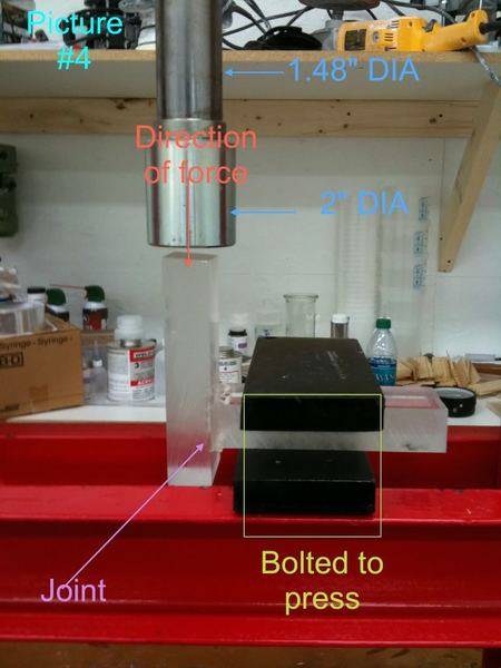

I have made 50 samples identical to the one shown in the pictures. I want to test shear strength with the samples.
(See picture #1).
My thoughts are this; using a bar of steel to distribute the pressure evenly across the joint I would apply force with my press (red arrow). The sample will naturally want to tip as pressure is applied. In order to prevent the sample from tipping I would keep the opposing side supported with a bar of steel (green box). By supporting the opposing end (green box) will this affect the accuracy of my test results? Would it make the results artificially higher?

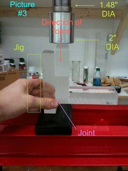

Acrylic flexes even over a short distance. Flexing will act as a lever and fulcrum correct? Should I move my support bar in further towards the (red arrow) to prevent flexing?
(See picture #2) Or will this affect the results of the experiment?
(See picture #3)
Should I have the samples held from the backside in this manner using a steel jig?

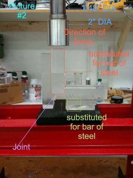

(See Picture #4)
Or should I have the samples held like this?

Your setup will depend upon whether you want to test for only shear at the joint, in which case picture 4 looks most promising, as the workpiece is solidly secured to a framework, and if the jig is moved closer to the joint.
Picture 1 would test for shear and some sort of bending at the joint, but the workpiece is not secured in any way.
Picture 2 would just be pressing down more and more on the support as they are moved inwards and will not give a full indication of what force or stress is at the joint.
Picture 3 you could use to test failure to a bending moment at the joint if you move the pressure point farther to the right of the horizontal piece.

I also think that the set up in picture 4 is more promising.

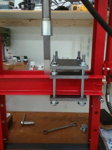

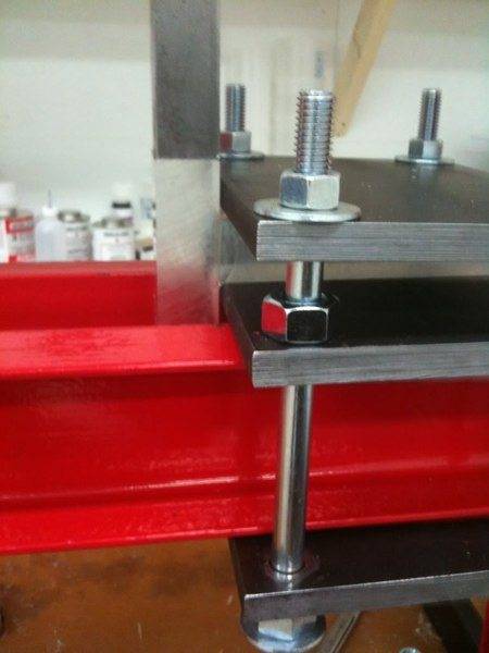

Well this is the design that I came up with today. (picture 1)
Here is the potential problem. The way these joints are made leaves a small lip on the outside edge that prevents them from recessing all the way into the holding jig. Thus they have to be positioned roughly 1/4" away from the edge of the jig.
I tested one of my samples to determine if my jig functioned properly.
As you can see in the second picture the sample broke at both the assembly joint and I assume at the jig contact line 1/4" away from the joint. Additionally even if the joint could be recessing all the way into the jig, it would still create a fracture line.
The fracture line places pressure on a single line causing false results. It would be similar to holding a piece of wood off the edge of table and pressing down on the exterior edge. It obviously will fail at the opposing break line at the edge of the table.

Picture 3 & 4 show the joint and why it can not recess all the way into the holding jig.

For the fracture line you speak of, perhaps lessen the stress concentration at the jig-workpiece by chamfering the jig edge and/or adding a veneer sheet of softer material between the jig and workpiece, such as wood or lead sheet.
