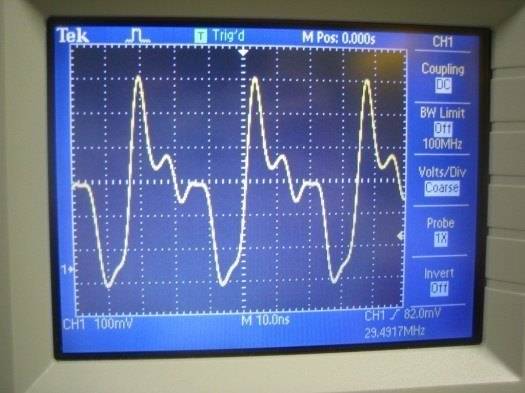

Those geniuses at that swharden.com link you provided paralleled outputs of a 74HC244 and sent this directly to their antenna, unterminated and unfiltered. Yikes!
Interesting. I do have an oscilloscope but I don't think it would be capable of reading 200 mhz signals.

Enthalpy said:
That's it. The circuit exploits the transistor's nonlinearity.
Vbe's threshold would reduce the conduction angle below 180°, making the circuit more efficient at producing 2nd and 3rd harmonic, but the transistor's limited speed makes the waveform smoother and less harmonic-rich.
I used it up to the 5th harmonic, but this is exaggerated. The main limit is the selectivity, hence accuracy, of the output filter. A multistage filter gets any desired selectivity, but only if it pick the proper harmonic under any circumstance. As a doubler or tripler, two LC are a good value, then Q=10 uses to be more than enough.
Before chips were available, PLL were too complicated hence uncommon, and this circuit was standard practice. Still nicely simple, and it introduces less phase noise than a PLL.
Symmetric circuits, with two transistors, reduce the odd or even harmonics.
This is sooo cool! So does the transistor's capable running speed have to be at an exact value, or does it just have to be capable of running around that frequency?
