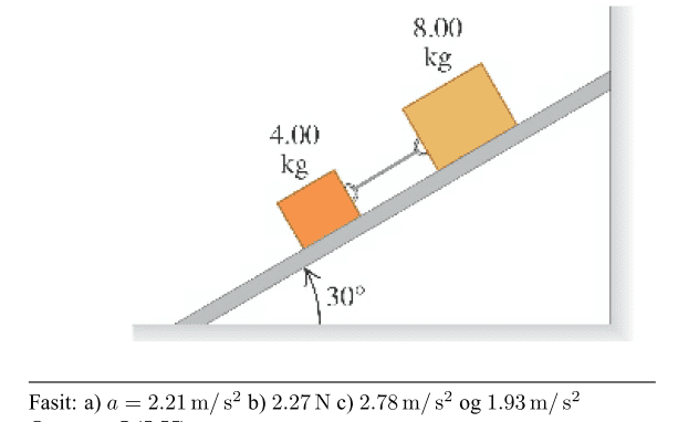

Greetings! This is my first post on this forum :)
("Fasit" means solution in Norwegian)
Inclined plane, 30 degrees from horisontal
Two boxes tied together.
BoxA = 4 kg, friction coefficient = 0,25
BoxB = 8kg, friction coefficient = 0,35
Box A is closest to the bottom of the plane. Box B is slighly above. Not touching.
A: Find each box' acceleration (the solution implies a common acceleration)
B: Find the tension between the boxes
[tex] a = (g * sin(30)) - (\mu * g * cos(30))[/tex]
[tex] \sum F = m * a[/tex]
Regarding Part A
I found both boxes' individual acceleration using the formula above:
[tex]A_A = 9.81 m/s^2 * sin(30) - 0.25 * 9.81 m/s^2 * cos(30) = 2.78 m/s^2[/tex]
[tex]A_B = 9.81 m/s^2 * sin(30) - 0.35 * 9.81 m/s^2 * cos(30) = 1,93 m/s^2[/tex]
However, the solution is supposed to be [tex]2.21m/s^2[/Tex]
What am I doing wrong?
Regarding Part b
I am getting nowhere trying to find a solution for this part.
I have tried multiplying the difference in acceleration with box A's downward force, but I am not getting anything near the solution which is supposed to be 2.27 N

The boxes are tied together, so Box A cannot accelerate at a greater rate than Box B.
There will be some tension in the string which will reduce the acceleration of A and increase the acceleration of B so they are equal so you have to consider the forces on the masses, not just their acceleration.
If you look at each box separately, you must include all the forces on them. Including the tension in the rope.
First find the acceleration by treating both boxes together as a single system. What external forces act on the system?

As Doc-AL says it is easier to treat the two masses together and add up all the forces helping and hindering the acceleration of one large system.

I think you may have got your sines and cosines back to front this time? In your first attempt, the cosine was in the friction calculation, and the sine was in the "accelerating force".

What's the component of the weight parallel to the surface? Normal to the surface?

As PeterO has already pointed out, you are mixing up your sines and cosines. Answer my questions:

OK, the component of weight parallel to the surface would be mass times gravity times cosine(30) i suppose.
Normal to the surface should be the same as above with sine instead of cosine.
That's backwards. Consider what the normal component would be if the angle of the incline were 0 degrees. Or 90 degrees.
(Interesting that you had that correct in your first post. What happened to change your mind?)
Yeah.. i see. Flat surface = cosine 0 deg = 1 = no change.
I am going to do some new calculations now, and hopefully return with a sensible solution to this.
Thanks a lot for helping me out :)
New dawn:
First: Finding the friction force for both A and B:
[tex]FF_A = 0.25 \times 4kg \times 9.81m/s^2 \times \cos(30) = 8,5N [/tex]
[tex]FF_B = 0.35 \times 8kg \times 9.81m/s^2 \times \cos(30) = 23,8N [/tex]
[tex]FF_A + FF_B = 8,5N + 23,8N = 32,3N[/tex]
Second: Finding the x-component of weight for both boxes:
[tex]F_A = 4kg \times 9.81m/s^2 \times \sin(30) = 19,6N[/tex]
[tex]F_B = 8kg \times 9.81m/s^2 \times \sin(30) = 39,2N[/tex]
[tex]F_A + F_B = 19,6N + 39,2N = 58,84N[/tex]
Third: Subtracting friction force from weight:
[tex]58,8N - 32,3N = 26,5N [/tex]
Fourth: Applying Newton's second law:
[tex]A = \frac{\sum F}{m} = \frac{26,5N}{4+8kg} = 2,21 m/s^2[/tex]
Thank you so much, Doc Al and Peter for getting my pieces together
OK, I am suddenly on a roll now and figured out Problem B as well.
B: What is the tension between the boxes.
First step: Determine Box A's desired weight downwards:
[tex]F_A - FF_A = 19,6N - 8,5N = 11,1 N[/tex]
Second step: Determine Box A's current weight downwards:
[tex]4kg \times 2.21 m/s^2 = 8,84N[/tex]
Third step: Tension between box A and box B has to be the difference in actual and desired weight:
[tex]11,1N - 8,84N = 2,26N[/tex]
