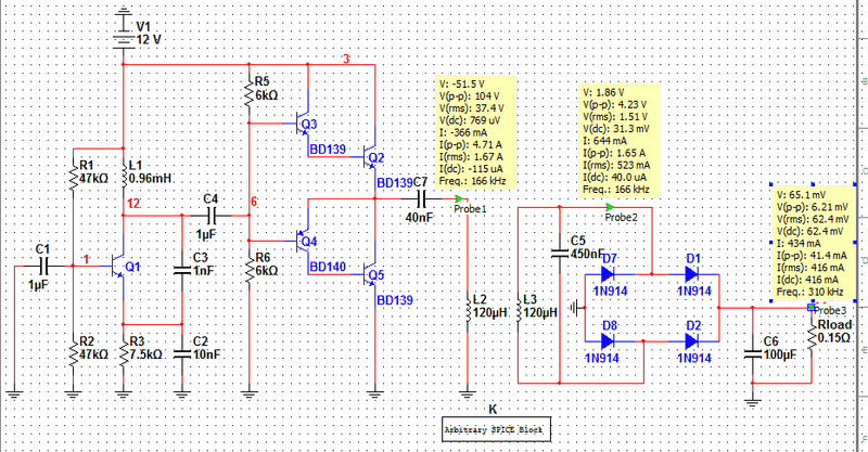

Hey guys,
I'm designing a wireless cell phone charger that can be used inside a car for the senior design project. I'm feeding 12V DC into a colpitts oscillator which is fed into a B class power amplifier which will then be fed into the transmitting coil. Each one works great independently but when I connect them together, the voltage swing is off. It goes from about +4V to -8V and I would prefer it to be +6V to -6V.

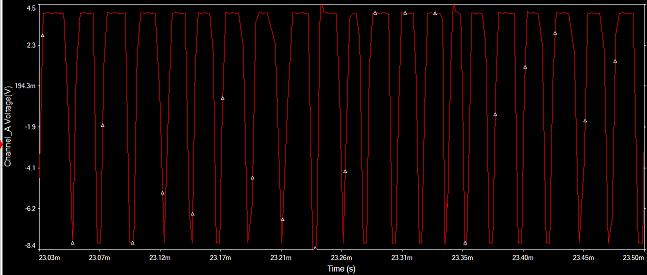

Also, the peak voltages cut off... I'm guessing from the fact that the input voltage is the same DC input that the transistors run off. What is wrong with the circuit?
I attached the schematic as well as the output (and a zoomed in output).
Q1 is a general purpose BJT (2N2222)
Thanks for the help!

You're right. I didn't even see that. I changed it but it gives the exact same output as before.
Try working backwards to see where it goes unsymmetrical - i.e. see what voltage you have at points 1 2 and 3.
Also, since your plot looks "ragged", try to plot enough points so you can see the actual waveforms. It could just be an artefact of how you plotted the output.
It seems that you haven't actually applied any bias voltage to the bases of your complementary pair of transistors. Their operating point will just be defined by some sort of 'mutual agreement between them' and could be anywhere.
Thanks guys. I changed/added some things in the circuit that fixed the problem. Another problem was that the two oscillating capacitors were reversed. I ran into another problem though.

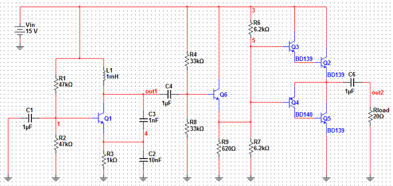

I finally solved the main problem I was having with connecting the oscillator to the power amp. I needed a buffer amplifier between them as well as drop the biasing diodes in the power amp. My professor said that crossover distortion is nearly eliminated with a tuned circuit. Attached is the schematic and its output.
EDIT: Now that I'm thinking into the <1W constraint, how can I possibly deliver enough current to the cell phone? It seems that 1W itself cannot charge a cell phone battery (3.7V Li ion, 950mAh) very well let alone needing the signal to travel to the receiver AND go through the rectifier. What do you guys think? Should I find another frequency range that is allowed more watts? Am I not understanding FCC Regulations letter a?
