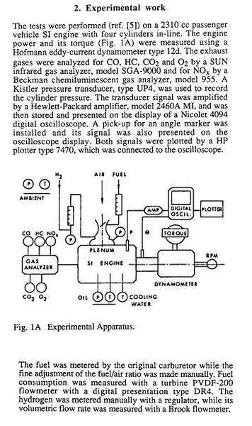

Previously, on this forum I have stated that I used the electrolysis device as a gasoline combustion enhancement and reported success in increasing fuel economy. I explained how I thought the device worked, but my ideas were incorrect; particularly, the argument regarding the alternator. Therefore, the refuting arguments from other posters appeared to show that this device could not work and that my results must be due to something else other than the device.
Henceforth, with my basic and limited chemistry background I have been trying to analyze the energy balance among the inputs and outputs, since the totality of the systems and processes involved in such an analysis is more complicated than the arguments of antagonists suggest. Currently, my analysis shows that I am inputting more energy into the system than I am getting out. Although my analysis is deeper and supports the general argument against the viability of the device, I still feel that I am missing key parts in my analysis.
I was curious and decided to search the academic literature to see if their was any publications about this electrolysis device. Surprisingly, I did come across an article that describes the device that I am trying to analyze. Unfortunately, it is not very quantitative, yet my perspective on the issue has become more optimistic. Moreover, the authors cite three sources that support using hydrogen as a combustion enhancement.
For interested readers, the article's citation is listed below.
Z. Dulger, K.R. Ozcelik. Fuel economy improvement by on board electrolytic hydrogen production. International Journal of Hydrogen Energy. 25, (2000), 895-897
Does anyone know the reputation of these authors or how to discern it? Ethics has been an issue in controversial scientific issues.

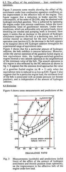

I found another interesting article that should help to clear up the debate over whether or not an on board electrolysis device improves fuel economy.
As the main focus for the paper, the authors developed a model to analyze the effects of hydrogen as an additive to the combustion energy output of methane fuel. In general, the results are positive; an addition of a small amount of hydrogen increases engine output power. There are many studies in the literature that support this idea.
The important part of the paper in regards to this thread was when they modeled the viability of using an on board electrolysis device to produce hydrogen and oxygen. The authors assumed efficiencies of 70% and 30% for the electrolysis device and the overall electric generation and mechanical efficiency, respectively.
The graph of their results is posted as an attachment. The line designated "PROD ENERGY" represents the total energy needs to run the electrolysis device. Based on their brief analysis, the authors state that the viable range of beneficial operating conditions is narrow and that the idea is not economically advisable.
So what do these results mean? Can the electrolysis device really work? I guess the answer is that it depends; the main zone of engine operating conditions one consistently drives within plays a large role, which probably lends support to why there is such a divide among people regarding this topic.
I have two important things to point out to the reader concerning this graph. First, the primary fuel used in the analysis was methane rather than standard grade gasoline. Second, their graph is based on a compression ratio of 8.5:1. I believe that most standard vehicles have a compression ratio of 10:1. In the main body of their paper, the authors show that this compression ratio has a power output about .3 kW greater than the 8.5:1 ratio with the addition of hydrogen.

A few comments about the attached graph... Each of the dashed/dotted lines represent different equivalence ratios. The graph includes the energy requirement to produce the Brown's gas. Notably, the Prod Energy line is only shown for that portion of the graph that would account for a maximum usage of only about 0.35 mmol/cycle. More than that and the line 'rockets' off the page!
The equivalence ratio is defined as the ratio of the actual fuel/air ratio to the stoichiometric fuel/air ratio. We see in this graph that by varying that ratio between 0.55 (quite lean) and 0.75 (somewhat lean) and then including varying concentrations of Brown's gas, changes in the power output are realized. The magnitude of these changes becomes less and less as we approach a stoichiometric ratio... we only get 3/4ths of the way there in this graph. The 0.75 equivalence ratio line (the uppermost dashed line) shows a modest increase of from 2.5 kW to ~2.7 kW when only 0.2 mmol/cycle of the gas are used. That represents a net increase of only 0.2 kW and to achieve even that level, the electrolysis requires a whopping 1.7 kW of energy which leaves us with a power deficit of roughly 1.5 kW when the unit is operating in that region. I am analyzing this line only because most modern automobile engines operate at or near stoichiometry and this line is the closest to that reality.
If we assume that we have an engine operating at an eqivalence ratio of 0.6 the story is different. This is a quite lean condition but shows the maximum response to injecting Brown's gas in this graph. I estimate that the maximum positive effect of introducing Brown's gas occurs at an injection rate of approximately 0.1 mmol/cycle. This results in an increase of power of ~1.3 KW (1.4 kW at 0.1 concentration of BG - 0.1 kW at 0 concentration of BG). To produce that level of BG, the graph indicates that about 1 kW of energy is required yielding the reported 0.3 kW maximum benefit.
To calculate the Prod Energy line, the author's use an alternator efficiency of 70% (typical values are 55% however, Bosch introduced one that operates at 70%) and an electrolytic efficiency of 30% (small 1kW+ plants can operate at 55%) so the best case scenario could be somewhat more than a 0.3 kW net advantage. Of course, electrolysis plants of 1kW are expensive and anything you could probably come up with in your garage wouldn't be nearly 55% efficient at electrolysis.
Of course none of us drive a car that operates on methane at an equivalence ratio of 0.6! Our cars operate at equivalance ratios of >1 most of the time and we run on gasoline. I suspect that as the molecular weight of the fuel increases and when operated on the other side of stoichiometry that the rather large increases in power (30% in this paper) will vanish into the negative region and it will likely cost money to run the system.
Actually, it's the other way around and includes the mechanical efficiency as well. Taken verbatim from page 582, "This production energy was based on a 70% effectiveness of the electrolysis and an overall electric generation and mechanical efficiency of 30%."

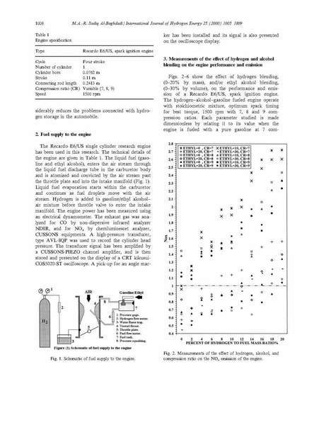

I came across another interesting article. Here is the citation:
Maher Abdul-Resul Sadiq Al-Baghdadi. Performance study of a four-stroke spark ignition engine working with both of hydrogen and ethyl alcohol as supplementary fuel. International Journal of Hydrogen Energy 25 (2000) 1005-1009.
I attached the graph as well.
Basically, a 2% mass fraction of hydrogen relative to gasoline results in a "specific fuel consumption" (sfc) value of about 0.5, where 1.0 represents the sfc at 0% mass fraction.
I posted three citations so far and wanted to comment personally about the authors. For the first citation (Z. Dulger, K.R. Ozcelik), I seriously question the authors' results--article was a technical communication, it lacked quantitative data, and stated that they used a novel bonding material to form the carbon electrode (this novel material was never mentioned). For the second citation (S.O Bade Shrestha, G.A. Karim), I feel that this is a quality article--the authors have many publications on the subject and even stated that the idea of on-board electrolysis does not appear economically advisable. For the third citation, I haven't found anything yet to make me question the authors' claims.

Recently, I stated that I would complete an analysis on the viability of the device over a range of driving conditions. I feel that this is no longer necessary, because I came across a new journal article that is likely to mirror what my analysis should show. The citation of this article is the following:
Y. Hacohen and E. Sher. FUEL CONSUMPTION AND EMISSION OF SI ENGINE FUELED
WITH H2-ENRICHED GASOLINE. Proceedings of the 24th IECEC, Arlington, VA, USA, 1989
I attached three images that detail the experimental work and effects of hydrogen addition over various engine conditions. I have added lines within Figure 3 which are used for the following analysis:
Figure 3 shows that at a stoichiometric ratio of about 0.95, the difference is bsfc between no hydrogen addition and 1% hydrogen addition is 9%.

Both of these values are short of the 1% relative hydrogen mass fraction value needed so that no energy losses occur.
Unfortunately, I can only analyze the data provided, so I would like to provide some comments for your consideration. First, it is highly unlikely that any of these devices can produce 1% hydrogen mass fractions given the nature of the car components; this would be about 50 grams of hydrogen per hour, well above the upper ceiling values for typical car alternators that I computed on post #59. Therefore, the actual hydrogen ratio will be smaller in value. The car kits sold on the internet supposedly produce 2 grams of hydrogen per hour from what I have heard; personally, I believe that 10 grams per hour is obtainable.
Second, if you look at figure 3, you will see that the bsfc values between 1%, 3%, and 5% mass ratios vary by a little amount (maybe 2%), so how would a 0.5% hydrogen mass ratio be plotted on this graph? Would it vary from the 1% mass ratio by 2% as well, or would it be smaller or larger? You must determine this for yourself.
Lastly, by assuming the mechanical and electric generation efficiency and electrolysis efficiency values of 30% and 60%, respectively, (18% total efficiency) we see that to produce 1 gram of hydrogen we need about 5 times more energy than the theoretical value. This fact shows that if we try to produce a higher mass fraction ratio that we lose more and more energy; for example, if we used the 5% mass ratio plot in our analysis, we would be even further away with our final numbers than with our analysis of 1%. If we assume that 0.5% and other smaller mass ratios follow similar behavior according to the plots on the graph, then we would actually find that we are gaining energy, and thus conserving fuel.
