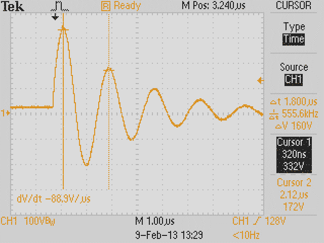

I'm sure it did, but the zener is a forward biased diode in the reverse direction, and the voltage across wouldn't show up when the scope is set to 100 V/div.
I assumed that initial offset was [somehow] due to the power supply, but you say it isn't? Can you account for it? (The blue line marks zero, does it?)
Furthermore, almost all the energy in the inductor was dissipated in the zener by the time reversal would occur.
Reversal occurs the instant that the power supply disconnects.
It's easier to just use a current probe.

Have a look at the capture where there was no clamping device. The first voltage excursion, which occurs just after the disconnection from the power supply, is positive going. I thought you were referring to the polarity reversal that occurs at 2.5 divisions, during the ringing.

No, I wasn't referring to the unloaded ringing. I refer to the clamped waveform on which I added the blue notation: at the vertical rise the inductor voltage reverses and it stays reversed for the duration of that steady 120V* level. I expected the zener's voltage prior to that vertical rise would be of opposite polarity to what it is after that point, and I can't account for it not changing polarity at that point.
I'll look into your "blue line" question when I get back home in a day or so.
Fine, no hurry, I think this thread will still be going strong.
* is the oscilloscope indicating your "approx 100V" zener is close to 120V?
What does the 64V figure on the foot of the display indicate?

It's the trigger level, corresponding to the orange arrow on the right side of the screen.
Feb13-13, 04:57 AM   #74
Concerning the offset you asked about in post #69. I connected the power supply to the inductor with a pair of alligator clip leads, and performed the disconnect by simply touching and then "un-touching" one of the alligator clips. When doing this, one gets a spark every time, and usually you don't get a clean ring waveform. I had to do it a number of times to get the waveform I posted. Even though I was able to get a single disconnect without any bounce, there was still an arc. The offset voltage you asked about is the voltage of the arc. The true disconnect doesn't happen until the arc stops, then the inductor current is truly interrupted.
This capture shows what happens with a current probe monitoring the current. The orange trace is the voltage across the inductor, and the blue trace is the current measured with a current probe clamped around the external inductor lead. Starting at the left edge of the screen until about 3.8 divisions, the current is ramping toward zero, the alligator clip having been disconnected and arcing is in progress. At 3.8 divisions, the ramp stops and the current suddenly jumps to zero and the ringing at the self resonance frequency commences. The oscillation results from energy exchange between the distributed capacitance of the inductor and the inductance itself. This oscillating current and voltage occurs completely internal to the inductor and no sign of it is seen in the blue trace which is the current in the external inductor lead.
