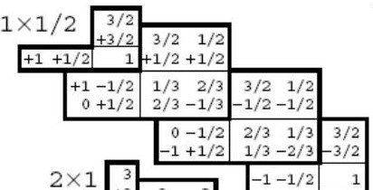

Find the Clebsch-Gordan coefficients associated with the addition of two angular momenta [tex]j_1 = 1[/tex] and [tex]j_2 = \frac{1}{2}[/tex]
The table of coefficients.
I think I am misunderstanding something important here. I can't see how it is possible to find the proper coefficients without more information since these two particles could be in a number of different states that satisfy [tex]J=\frac{3}{2}, \frac{1}{2}: \frac{3}{2}\frac{3}{2}, \frac{3}{2}\frac{1}{2}, \frac{1}{2}\frac{1}{2}, and \frac{1}{2}\frac{-1}{2}[/tex]

Yes there are a number of states, but there is a Clebsch-Gordan coefficient for each of them. The CG coefficients are labeled as [tex]\langle j_1m_1j_2m_2| JM\rangle[/tex].
Right, but I am having trouble seeing how it's possible to move forward without knowing M, [tex]m_1[/tex] or [tex]m_2[/tex].
From what I can tell, the furthest I can go is to say
[tex]\sum_{m_1+m_2=M}C^{1,\frac{1}{2},J}_{m_1,m_2,M}\mid 1 m_1\rangle \mid \frac{1}{2} m_2\rangle[/tex]
The way you generally compute CG coefficients is to identify the highest and lowest weight states and then act with the ladder operators :

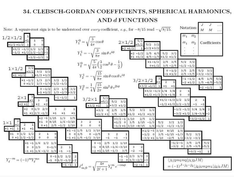

While that does seem like an easier way to do it, the point of the exercise is to learn how to read off the values from a table (see attached picture). Clearly I'm looking for something in the 1x1/2 table (second picture), but beyond that I'm lost.

Each state is labeled by [tex]m_J[/tex]. For each of these states, you can determine what allowed values of [tex]m_{1,2}[/tex] can appear in the linear combination you wrote in post #3. The coefficients in the linear combination are the CG coefficients you can read off the table. Remember that you usually need to take a square root of the number in the table to get the CG coefficient.
Oh, so do I just find the coefficients corresponding to the 3/2 case and do a linear combination of them (using the appropriate coefficients from the table) and then do the same thing for the 1/2 case?
