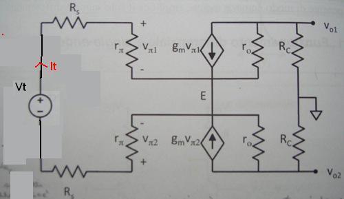

Hello, I'm having some issues with small-signal analysis of BJT differential amplifiers.
Let's say I have this BJT differential pair and suppose that Q1 and Q2 perfectly match: http://i50.tinypic.com/14ahdgn.jpg
Suppose a small differential input is applied and consider the small–signal equivalent circuit:
Having two opposite-phase inputs with the same amplitude ([itex]\frac{v_d}{2} , - \frac{v_d}{2}[/itex]) makes the potential of the emitter E stuck at its initial value.
My book says that:
- If the potential of E is stuck at its value, then E can be considered as a ground point for the small-signal circuit;
- If E is grounded, then every point the two circuits have in common is grounded; this means that the two circuits become totally independent one from each other and I can solve the small-signal circuit of Q1 and Q2 separately;
Can anyone please explain me the reason for these two statements?
One last question: both small-signal circuits of Q1 and Q2 have an input impedance [itex]r_\pi[/itex] and an output impedance Rc || [itex]r_o[/itex].
What's the input/output impedance of the whole differential pair?
Thanks in advance for your time.

Okay, I think I got it.
Just one thing: to compute the input impedance of a circuit, I usually disconnect the signal generator and its own resistance and replace it with a test generator, let's say a voltage generator Vx. The input impedance is defined as Vx / Ix , where Ix is the current flowing through the generator.
If I want to apply this method to the differential pair, I guess I should disconnect both [itex]\frac{v_d}{2}[/itex] and [itex]-\frac{v_d}{2}[/itex] (and the two [itex]R_s[/itex] resistors) and replace them with a test generator connected between the positive terminals of the two [itex]r_\pi[/itex] resistors.
Is this right?
Yes, you use this circuit to find Rin

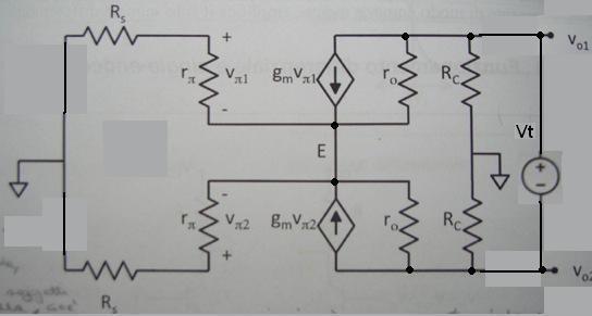

And this one to find Rout
And from this diagram when we assume full symmetry. From the inspection we can see that
Rout = Vt/It = 2Rc||2ro

I disagree with output impedance of a single CE amplifier is not equal ro/(β+1).
As for differential output impedance Rout = (2Rc*ro)/(Rc + ro)
Yes, you are correct. The output impedance of a CE is ro/(β+1) only if it is driven by a current source. Otherwise, in this voltage driven case, it is ro as you pointed out.
