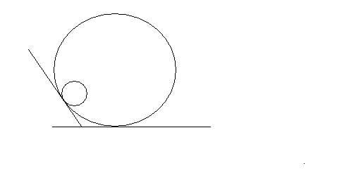

Getting back to the original post, assume that both balls start off with the same contact point height. The height to the center of mass is the starting height + radius x cos(slope angle). Once on the straight, the height of the center of mass is the radius. The smaller marble descends a greater distance and ends up with more speed.
Assume slope angle ~= 36.87 and cos(slope angle) = .8
Assume starting height = 10 inches
Assume radius of marble_1 is 1 inch
Assume radius of marble_2 is 2 inch
Initial height to center of mass of marble_1 = 10 + 1 x .8 = 10.8 inch
Final height to center of mass of marble_1 is 1 inch
Distance marble_1 descends = 10.8 inch - 1 inch = 9.8 inch
Initial height to center of mass of marble_2 = 10 + 2 x .8 = 11.6 inch
Final height to center of mass of marble_2 is 2 inch
Distance marble_2 descends= 11.6 inch - 2 inch = 9.6 inch
marble_1 descends 9.8 inches while marble_2 descends 9.6 inches, so marble_1 ends up with more speed than marble_2. The obvious case is when the radius of marble_2 is so large that it touches both the slope and the straight section in the iniital state and doesn't descend at all. As long as marble_2 is larger than marble_1, eventually you reach a time where marble_2 is touching the flat and stops descending, while marble_1 is still descending.
Inertia wasn't the issue here, it was the difference in the distance that the marbles descend.

If the stop gate is parallel to the floor, both marbles reach the floor at the same time with the same speed. If the stop gate is angled upwards, the larger marble is pushed back, the smaller marble reaches the floor first, and vice versa. For a soap box derby, getting the center of mass as far aft (above) of the stop gate would increase the GPE of the initial starting point.
Thanks, Jeff.
Let's assume now that both marbles have the same radius, but one is more massive than the other. That is, try to remove the factor of the larger marble reaching the bottom sooner because it's radius is larger, as illustrated in your graphic. Both marbles would then reach the bottom at the same time. (Right?) (For all these cases, I'm assuming the marble is rolling, not slipping/falling)
Also, can you explain why inertia isn't the governing principal here? In my mind, I was comparing the two marbles for two vehicles on a highway, both traveling 60 miles/hr, one being an 18-wheeler, and the other being a Volkswagen Beetle. In this case, if both drivers take their foot of the gas at the exact same time, won't the 18 wheeler take longer to stop, because of inertia/ having more momentum? (Assuming this is correct...) what makes the case of the marbles different?
