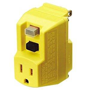

So what happens when this amp is plugged into a GFCI outlet?
Your point is? Have you ever played in a club when the receptacles on the stage were CFGI's. I have been playing music for over 40 years and have never encountered one.
Your deflection of this topic is not relevant.

I disagree. Being shocked is what GFCI's were designed to prevent. And that is what the OP is complaining about.
If there are any musicians out there with amps designed to kill you, please join the PF postcard club, send me your amp, and I'll fix it for free. Shipping and insurance on such antiquated stuff not included.
Cool your jets. I asked a simple question. If you want me to assume you don't know what you are talking about (or at the very least don't know what would/should happen if it is plugged into a GFCI), then your reply has done just that.
You will never find such a ground-fault receptacle on any stage in any tavern or club. That would be ideal, but you will never see it. Bands come and go, with no discipline, for the most part, and no venue would possibly re-wire such that entire sections of the band would drop out on a whim.

Turbo I never said "ALL STAGES SHOULD USE GFCIs!" My point is that if a GFCI won't run something without tripping it should not be run without a GFCI either. I don't think anyone in this thread is harping on safety as much as you are yet you seem to miss a lot of points. Hell, you even point blank asked me:
Your point is?
