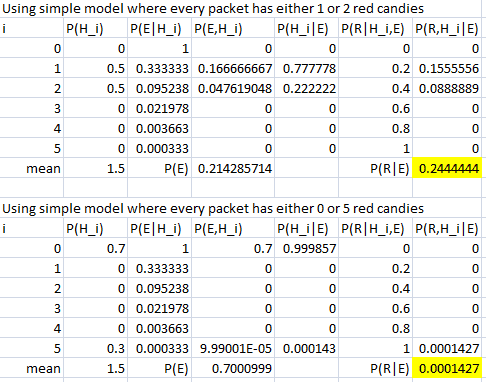

bpet;2932123it is sampling without replacement from a [B said:
finite population[/B] so the probability of success does increase slightly with each failure (though as Hurkyl pointed out, not enough to notice the difference).

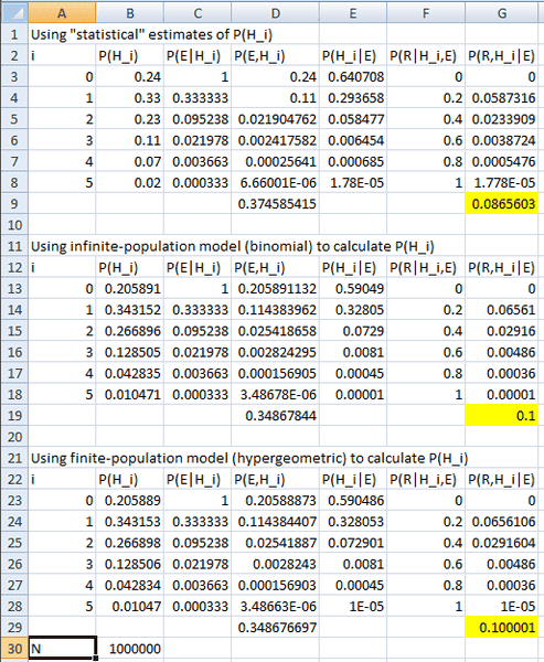

No, it does not! The reason is because you do not know how many red candies were in the bag in the first place.
I'll give a concrete example. Suppose that, after lots of research, your class has found that bags of some selected size always contain 15 candies, and that
  • Some bags have no red candies (p=0.24),
  • some have one (p=0.33),
  • some have two (p=0.23),
  • some have three (p=0.11),
  • some have four (p=0.0.7), and
  • some have five (p=0.02).
Note that this averages to 1.5, or 10%, red candies per bag.
Now suppose you pick an unopened bag of this size. Prior to opening the bag all you know is that this bag contains 15 candies. You do not know if it contains no red candies or five. All you know is that, on average, a bag of this size contains 1.5 red candies. If asked what the probability that the first candy drawn will be red your best bet is to say 10%.
You don't get a red candy on the first draw. You keep drawing candies, never drawing a red in the first ten draws. Assuming that the previously examined bags are exemplary of this particular bag of candies, this drawing of ten non-reds in a row gives you a good guess regarding the red/non-red makeup of the remaining five candies in the bag. The probability that all five are red has shrunk to a tiny number; you almost certainly would have drawn one or more red candies somewhere in those first ten draws if the bag did contain five candies. The same goes for the bag containing four, three, two, or even one candy. On the other hand, the probability that you have one of those lousy bags with no red candies has risen from the nominal 0.24 to 0.64. The probability that the next candy will be red is 0.087: Smaller than the default 0.10.
Sorry could you explain how 0.087 was calculated? Calculating the probability a different way, if there are N candies in the world of which exactly 10% are red, after we draw 10 non-reds the probability of drawing a red next would be (0.1*N)/(N-10) which is larger than 1/10.
You are not drawing, without replacement, from a sample space of N candies of which N/10 are red. You are drawing, without replacement, from a sample space of 15 candies of which an unknown number are red. Well, not quite unknown. We do know that the number of red candies in the bag was not six, for example. There would have been no way to draw ten non-reds in a row from a bag containing nine non-reds and six reds.
What I did was to apply Bayes' Theorem, one form of which is
[tex]P(H_i|E) = \frac {P(H_i)P(E|H_i)}{\sum_j P(H_j)P(E|H_j)}[/tex]
Here,
  • E is the evidence that has been gathered (or an event that is known to has occurred). In the problem at hand, E is the fact that the first ten candies drawn from a bag of fifteen M&Ms were not red candies.
  • The Hi are a set of mutually exclusive hypotheses that collectively encompass all of the possible explanations. In the problem at hand, we can hypothesize that of the fifteen M&Ms originally in the bag of candies that
    • Hypothesis H0: The bag contained zero red candles.
    • Hypothesis H1: The bag contained one red candles.
    • Hypothesis H2: The bag contained two red candles.
    • Hypothesis H3: The bag contained three red candles.
    • Hypothesis H4: The bag contained four red candles.
    • Hypothesis H5: The bag contained five red candles.
  • Each P((E|Hi) is the conditional probability of the evidence given hypothesis Hi. In the problem at hand, these conditional probabilities can be calculated via the hypergeometric distribution:
    [tex]P(E|H_i) = \frac{(15-i)!5!}{(5-i)!15!}[/tex]
  • The P(Hi) are the prior probabilities of the hypotheses Hi. In general, these prior probabilities can range anywhere from educated guesses to values based on some deep understanding of the problem at hand. In this case, we have some meticulously collected empirical data regarding the number of red M&Ms in bags that contain fifteen M&Ms.
  • Finally, the value on the left-hand side, P(Hi|E), is the posterior probability of hypothesis Hi given the evidence collected.
Bayes' Theorem is a very powerful statistical tool. In this case it let's us get an updated estimate of the original contents of the bag even though we have only examined some of those contents. The following table presents the Bayesian analysis of the problem at hand:
[tex]
\begin{tabular}{clllll}
$ i $ & $ P(H_i) $ & $ P(E|H_i) $ & $ P(H_i)P(E|H_i) $ & $ P(H_i|E)\qquad $ & $ P(R|H_i,E) $ \\
\hline
0 & 0.24 & 1 & 0.24 & 0.64070834 & 0 \\
1 & 0.33 & 0.33333333 & 0.11 & 0.29365799 & 0.05873160 \\
2 & 0.23 & 0.09523810 & 0.02190476 & 0.05847735 & 0.02339094 \\
3 & 0.11 & 0.02197802 & 0.00241758 & 0.00645402 & 0.00387241 \\
4 & 0.07 & 0.00366300 & 0.00025641 & 0.00068452 & 0.00054761 \\
5 & 0.02 & 0.00033300 & 0.00000666 & 0.00001778 & 0.00001778 \\
\hline
Total &&& 0.37458541 & 1 & 0.08656034 \\
\end{tabular}[/tex]
Note that in addition to the quantities discussed above, the table contains one additional item in the rightmost column, P(R|Hi,E). This is the probability of drawing a red M&M on the eleventh (next) draw from the bag of candies given hypothesis Hi and given that the first ten draws were non-red candies.
The bottom right number, 0.08656 (or 0.087 for short) is the sum of these probabilities. This is the probability that the next candy drawn from the bag will be red given all of the available evidence, which is (a) the empirical probability distribution obtained by examining hundreds of bags of candies and (b) the fact that the first ten candies drawn from the bag being investigated were non-red candies.
D H said:
...The P(Hi) are the prior probabilities of the hypotheses Hi...In this case, we have some meticulously collected empirical data regarding the number of red M&Ms in bags that contain fifteen M&Ms...
[tex]
$ i $ & $ P(H_i) $ & $ P(H_i|E) $ & $ P(H_i)P(H_i|E) $ & $ P(E|H_i)\qquad $ & $ P(R|H_i,E) $ \\
\hline
\hline
\end{tabular}[/tex]
That's very interesting, only wouldn't the result change according to the choice of prior probabilities? If we take into account that the bags are themselves drawn from a finite population, then [tex]P(H_0)\approx0.21[/tex] etc when N is large and perhaps then the result would be closer to 0.1. Also, how were the [tex]P(R|E,H_i)[/tex] calculated - wouldn't they just be equal to i/5?
First off, I mislabeled three of the columns in the table in post #23. I have edited the post to correct that error. Sorry if that caused any confusion.

Of course. That is why in this hypothetical example the students collected lots of data involving hundreds, maybe even thousands of bags of candy.

Ok thanks, now I see where the discrepancy lies, you were using statistical estimates but we were able to assume that the exact proportion of red candies is known based on the production efficiency argument. I modified your table a bit to show how the probability increases as predicted using the simpler method (and put in what I think are the correct column labels).
  • M and M probabilities.xls
Neither of those simpler methods correspond to how one would sample candies, do they? You definitely are not drawing from a constantly-replenished or infinite source (binomial) nor are you drawing from a finite but very large source where you know the initial distribution (hypergeometric). Instead you are drawing from a small but somewhat unknown sample space that is selected in a somewhat unknown way from from an even larger sample space with a known distribution.

Ah yes, I was implicitly assuming that the mixing machine involves a large bucket filled with fixed proportions; as you said, isn't necessarily how the manufacturing process works. I wonder, if the mixing machine was a long funnel, what would the prior distribution look like; or if the prior is estimated from data what the uncertainty in the result would be.
I tried a few more models and found some examples with P(R|E) ranging from 0.00014 to 0.24 (see below). What a fascinating problem! Thank you, D H and Rage Spectate!

I think it'd help to hear your professors reasoning on the problem but in the original post you make it sound like he just said wrong and then you explained your reasoning and he simply said wrong again.
