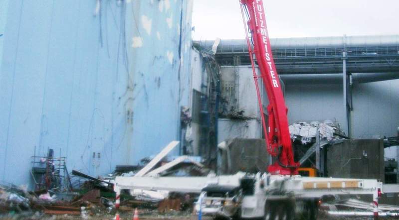

According to the simulation video ( http://www.tudou.com/programs/view/Cw5FeFIJxeI/ ) the side panels are put first and the roof panels are added at the very end.
[URL]http://www.tepco.co.jp/en/news/110311/images/110910_1t.jpg[/URL]
picture taken on 9 September: large size: http://www.tepco.co.jp/en/news/110311/images/110910_1.jpg
http://www.asahi.com/national/update/0910/TKY201109100129.html The removal of debris from the top part of unit 3 is starting today. It will take until next summer to remove an estimated 3500 m³ volume. This is done using remote-controlled machines installed on the top a U-shaped workstand (8 m wide, 30 m high, total length 150 m) surrounding the building. Each debris will be checked for radiations and sorted according to the radiation level. Debris removal will begin at unit 4 in the middle decade of this month. The radiation being lower, this will be performed with manned machines, while spreading a dust fixing agent with an elevated water spreading truck. To prevent debris from falling into the pool, the pool will be covered with a floating cover.
http://www.tepco.co.jp/en/nu/fukushima-np/images/handouts_110909_05-e.pdf Tepco press release on units 3 and 4 debris removal (English)
