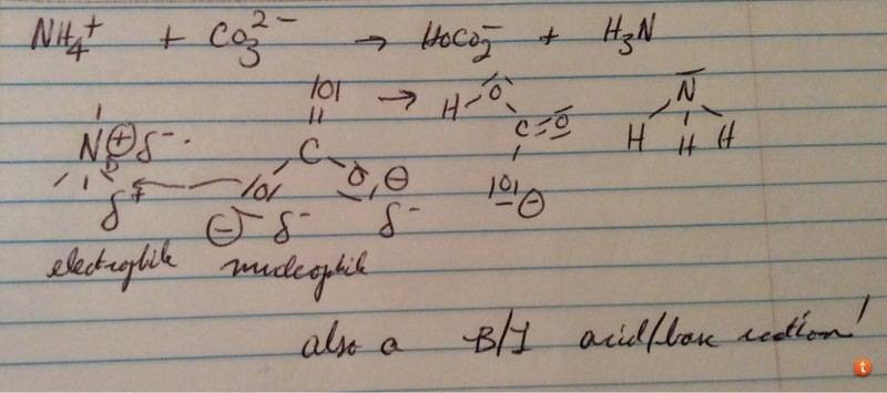

Right, that's what I thought, because I was once confused about why certain substances do not exist - i.e. are very unstable (think smelling salts like ammonium carbonate). These undergo a large-extent acid/base reaction (both Bronsted and Lewis I think).
