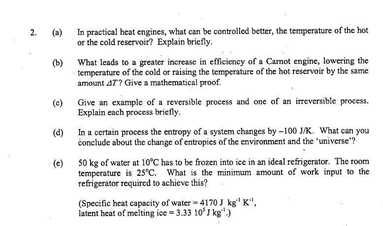

Need help with a question involving heat engines, the carnot cycle and entropy.

For
a) I imagine it is easier to control the temperature of the hot reservoir because you could use a constant heat source e.g. bunsen burner.
c) melting/freezing water.
d) Entropy of the environment increases and the entropy of the universe always increases.
Any help with b) or e) would be massively appreciated
b)
[tex]\eta=\frac{W}{Q_{in}}=1-\frac{|Q_{out}|}{Q_{in}}=1-\frac{T_{min}}{T_{max}}[/tex]
If you raise the temp of hot reservoir by [tex]\Delta T[/tex] you'll have: [tex]T_{max}'=T_{max}+\Delta T[/tex], and if you lower the cold reservoir by the same amount you'll have:
[tex]T_{min}'=T_{min}-\Delta T[/tex].
So the new efficiencies will be:
[tex]\eta_1=1-\frac{T_{min}}{T_{max}'}=\frac{T_{max}-T_{min}+\Delta T}{T_{max}+\Delta T}[/tex]
and
[tex]\eta_2=1-\frac{T_{min}'}{T_{max}}=\frac{T_{max}-T_{min}+\Delta T}{T_{max}}[/tex]
If you rearrange those two:
[tex]\eta_1(T_{max}+\Delta T)=\eta_2T_{max}[/tex]
So it is obvious that [tex]\eta_1>\eta_2[/tex] the efficiency of Carnot cycle is greater when you take away the temp from cold reservoir. :)
thats great, thanks
anybody have any idea for e), even just a prod in the right direction would be excellent.
For e), the condition for minimum work to be achieved is the coefficient of performance [tex]\eta = \frac{dQ_{cool}}{dA} = \frac{T_{cool}}{T_{hot}-T_{cool}}[/tex]
Where:
[tex]dA[/tex] is the work needed to lower the temperature by [tex]dT[/tex]
[tex]dQ_{cool}[/tex] is the heat taken from the water/ice.
[tex]T_{hot}[/tex] is the temperature of the sink, which is the air in this problem.
[tex]T_{cool}[/tex] is the temperature of the source, which is the water/ice. Notice that [tex]T_{cool}[/tex] varies during the process.
There is another equation relating [tex]dQ_{cool}[/tex] with [tex]dT[/tex] (actually 2 equations, each corresponds to one process). Compute the integral, and you will obtain the total work needed.
For b) The efficiency of a Carnot cycle is given by the equation e = 1- Tc/Th, where Tc is the temperature of the cold reservoir and Th is the temperature of the hot reservoir. Therefore, the efficiency of a Carnot cycle can be increased by increasing the temperature of the hot reservoir or decreasing the temperature of the cold reservoir. This can be achieved by using more efficient heat exchange methods and insulating the system to minimize heat loss.
For e) Entropy is a measure of the disorder or randomness in a system. In the Carnot cycle, entropy is conserved and remains constant throughout the cycle. However, in real-world systems, there is always some amount of energy lost as heat and the entropy of the system increases. This is due to the second law of thermodynamics, which states that in any energy conversion process, the total entropy of the universe will always increase. Therefore, it is important to minimize heat loss and increase efficiency in heat engines to reduce the overall increase in entropy in the universe.
