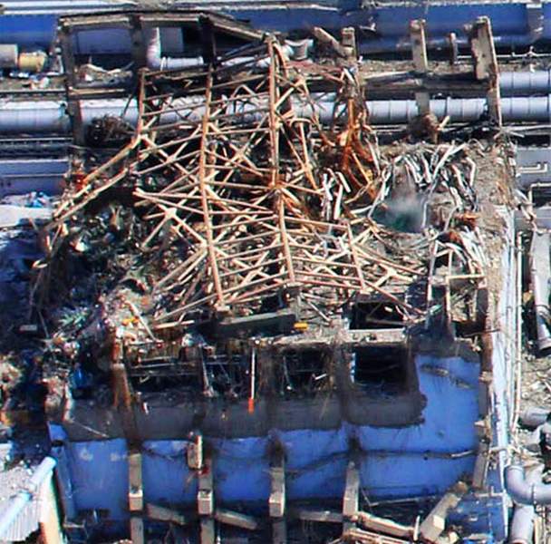

Hey Madder, the chances of a ballistic object landing in that configuration, parallel with anything and just a foot away from a wall,... and not deforming it's shape are quite frankly near zero.
If the object fell in that part of the roof, it probably rolled about until it hit the wall. That would account for its position.
As for deformation, it depends on where it came from and how sturdy it is. For example, in the Air Photo Service pics one can see a large dark gray metal box that was ejected from Unit #3 and was lying on the ground, some 30 meters southwest of the building --- apparently intact.

jlduh said:
The chunk has a very different appearence than on the other pictures I posted, where it looks clearly to be concrete, on this one it's not so clear but the rendering of the picture is bizarre. What is really surprising is the small amount of damages around or under it, like if it was delicately put there!
If it is the chunk I am thinking, then it is clearly one of the service floor wall panels --- some 5-7 meters across but perhaps only 30-40 cm thick. The following picture shows it clearly, and shows that it did bend the metal railings above the pipes. If it came from #4, its position and the lack of damage to the pipes are easy to explain. If it came from #3, it may have hit something else (such as the wall of #4 or of its turbine building) before landing there.
http://www.ic.unicamp.br/~stolfi/EX...isc4/drone/hires/aerial-2011-3-30-1-11-12.jpg
http://www.ic.unicamp.br/~stolfi/EX...isc4/drone/hires/aerial-2011-3-30-0-20-11.jpg
I'd be grateful if you'd point it out on a photo. To understand the explosion it is potentially useful to look at fragments ejected.
As regards the grey cylinder, in this video , right at the end, there is a brief sequence showing a firetruck spraying water to the roof, apparently in the direction of the object (two frames are attached, one before, and one after the firetruck starts spraying.
I ask forgiveness for presenting you to a video of this low quality, it is horrible, but it is the only source I know of which includes this particular sequence.
The video starts out with a brief sequence from the helicopter video shortly after the tsunami. There are better sources for this sequence.
The rest of the video appears to have been made by someone with the Tokyo Fire Department Hyper Rescue Unit. It shows bits and pieces of the emergency response at unit 3 of the Hyper Rescue Unit, around midnight between March 18 and March 19. The bits and pieces are timestamped throughout.
Parts of this sequence have better sources, but this source contains a few sequences which are not included there (in the sequence in which the photographer sits tight in the dark, in an apparently high radiation environment, with his camera showing a multitude of variations of radiation blips on the otherwise mainly dark background.)
Finally there is this brief sequence at the end, in which we see one of the trucks of the Hyper Rescue Unit spraying water to the roof close to the grey cylinder. The timestamp for this sequence is March 19 14:08.
This is this one but how do you interpret this view from the south from where the thickness seems huge:
http://www.netimago.com/image_201109.html
EDIT: hummm i think i got trapped by an optical illusion when i viewed it from this side... What i interpreted as thickness was in fact length seen from perspective angle i think!
The quality of your images seems better than mine and now i see better the shape of this object which is not so thick than i saw it. Damn optical illusion :confused:
