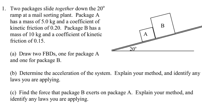

The question asks me: Determine the force of package B on Package A.
Now package A and package B are sliding down a ramp together, so they have the exact same acceleration. The acceleration of the system is 1.8 m/s^2 and the mass of package B is 10kg
So, is it simply F = ma
F = (10kg)(1.8) = 18 N ?
What is the problem you are working on, exactly as it was stated to you?
C is the question I am trying to solve.
What did you use as the frictional force for the system?
How did you find it?
