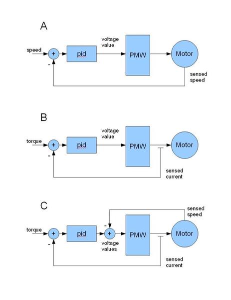

Hi,
I'm looking into the control of a PMSM (permanent magnetics synchronous motor) motors using H-briges and PWM (puls width modulation).
I'v seen motor controllers that use a PID controller for speed regulation. The output of the PID controls the PMW. This makes sense to me because the PMW controls the voltage of the motor phases and this is proportional to the speed. The speed is measured and feed back into the PID.
But now I want to regulate the torque, thus the current. I have seen implementations that use a PID controller with current inputs (reference and sensed phase current) and again the output of the PID controlling the PMW. So essentially the same setup as for speed control.
I do not understand this. The output of the PID should control the motor current. But it controls the voltage. The current will increase or decrease because of the voltage and inductance. So there is an extra integration going on. How is it possible such a PID loop works?
You can regulate either speed or torque but not both at the same time. The motor controllers I have worked with, control the speed, increasing the torque as needed until the torque limit is exceeded. At that point the speed is reduced to keep the torque (or current) from exceeding its set limit. Sometimes the torque is limited on startup to keep the motor from accelerating too rapidly.
If on the other hand you need constant torque, then the speed must be free to change in order to deliver that torque.
I understand that I can not control both torque and speed at the same time.
The point is that I do not understand how the torque regulation is done using the described PID controller with PMW.
The PID has current value inputs but controls the voltage of the motor. And the voltage of the motor is not proportional to the current because of the indictance. So how does this work?

My question still stands. How can a PID controller work when it compares current values as input and when it controls the PWM with its output. Because this PMW corresponds to voltage control. The current will increase or descrease because of the voltage. This is an extra integration.
I want a PID because I want to control the torque.

In that case, forgive me if I am thinking too simply or ignorantly here, but if you apply a voltage to a motor's terminals with any load whatsoever, then you will also have a current. Much like in a circuit you will have a current and a voltage with a load. If I tell you the voltage and resistance of a resistor circuit, you will be able to tell me the current with Ohm's law, and if I told you to increase the current by 10%, you could simply increase the voltage by 10% if R is constant. So if you can sense and control voltage, you indirectly are controlling current and vice versa because you know the inductance and resistance of the windings and the Km and Kt constants. You simply use a conversion factor to switch between the two. In a control system block diagram, you can tap between blocks to get the specific output,input, or variable you want to consider, but the system is still a closed loop.
For example, if a motor normally runs 600 RPM from an applied voltage of 50V, you already know what the torque will be at for a known load at that operating point. If you apply 50V, and the motor is running slower than 600 RPM, you know that the current has increased because the back EMF has dropped. The RPM that you're measuring is related to voltage by the motor constant, but indirectly you still know that the current has increased through the known relationship. So, you can lower the voltage in that case til the motor speed drops to a lower value, and for that value to correspond to the desired current by the known relationship.
That is how you could control torque indirectly from a voltage PWM/RPM measurement, but you could also have a shunt resistor to measure current semi-directly (but you could still control it with voltage by the relationship). If I'm off here, please explain to me why, because I will have a misunderstanding myself.
@DragonPetter:
Thanks for your answer.
I agree for a pure resistor the voltage control is equal to current control.
But we have a lot of inductance here.
I also agree that I could calculate the needed voltage given the motor speed and motor
parameters (like back emf and inductance).
But the PID regulator does not use al this extra information.
That is why I do not understand that the PID controller works properly. The PID outputs a voltage only given the sensed current and wanted current. No speed sensing, no motor parameters are used.

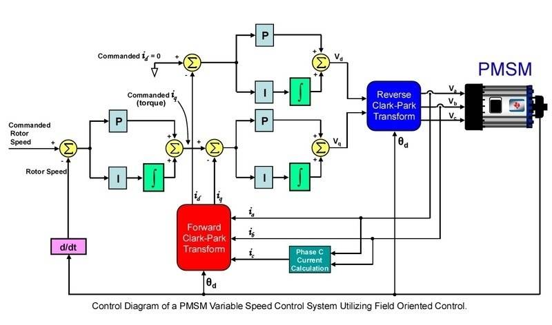

I found a better picture of a FOC controller.
Here you see the inner PID loops, controlling current.
And the outer PID loop controlling speed.
The rotor position is needed for the transformations.
The output of the inner PIDs control the PMW, thus controls the voltage on the motor windings. The voltage is propotional to motor speed, not motor current.
So why is the current feedback and not the speed?

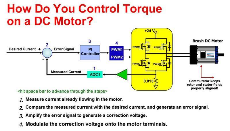

I found a better (much simpler) controller diagram to explain my question.
See attachment again.
Here the torque (is current) is controlled by a PI controller. The output is a voltage.
The PMW makes sure this voltage is applied to the motor.
But the motor current is feedback to the PI controller!
The voltage on a motor is more or less proportional to the motor speed. So it makes more sense to me to feedback the speed. The voltage will increase or decrease the current because the motor is an inductor. So the voltage gets mathematically integated. How can a PI controller work with this (integrated) feedback?
In your DC motor example, most recent post, ...
why can't two integrators be cascaded?
just their time constants need to be separated ..
and - feeedback is measured current and is compared to desired so error will be forced to zero
so far as the control system is concerned, output is measured current
and motor's transfer function is just one more term
motor coild be moved inside yellow block
try thinking of the motor as a first order lag instead of an integration
because it really does have an L/R time constant so will not integrate for very long.
any help?

So what you are saying is that you can control the motor current by controller the voltage in a more or less proportional way. And the integrattion will not disturb the PID controller?
As you see in the example you provided, the PI controller block diagram has the conversion built into it.
Applied voltage is not directly related to motor speed. It is proportional, but the actual speed is dependent on other factors too - the current/mechanical load.
It is the back-EMF that you need to think about. And the back EMF is the parameter that is dependent on the angular velocity of the rotor. It fights with your applied voltage as an inherent negative feedback, and when the motor is producing higher torque, the back EMF has decreased for the same applied voltage. Your current relationship comes into play here, as this back-emf reduction causes a larger voltage drop across the windings -> more current through them. The parameters are all related by equations, so it is not magic that you can control the current with the voltage.
Saying the motor is an inductor really does not have much importance with the current/voltage relationship other than the back EMF effect. The inductor aspect is more important for understanding electrical transient behavior of the motor, about just as relevant as the internal resistance of the motor as far as your original question goes.
The answer to your question really boils down to following the units conversions in the block diagram path. Like I said, it is a conversion factor that is built into the closed loop somewhere that translates an applied voltage to the motor's current.

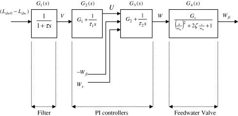

second - cascading controllers is tricky but commonly done.
look up three element feedwater control.
drawing courtesy of this fellow: http://www.controlguru.com/wp/p44.html
LC and FC are both p+i 's, and boiler integrates the flow error...
here's an image that looks more like my feedwater control system
G2 and G3 in cascade
courtesy of this fellow: http://ars.els-cdn.com/content/image/1-s2.0-S0307904X07000686-gr3.jpg
here's a nuts&bolts explanation i use for my guys:
since flow measurement Wf and Ws into flow controller G3 is imperfect, level controller G2 will force level to desired with whatever offset in reported flows W makes system settle.
observe there's a boiler closing the loop, it integrates the true flow mismatch. so i see a 3 integrator closed loop.

Thank you both very much for explaining all this stuff.
I think I start to understand now why you can control the current by applying a voltage calculated by the PID that has current values as input.
I found an example where a measured speed is used to compensating for the back-emf by adding some value (depending on speed) to the voltage output of the PID. So that the voltage will be incremented automatically at higher speeds to compensate the back-emf.
This way the PID does not have to deal with the back-emf (or has to deal less with it).
Do you think this is a good idea?

This link is a quick introduction to the FOC method
http://www.ti.com/lit/an/bpra073/bpra073.pdf
and is my first exposure to it
but it helps.

For better dynamic performance, crosscoupling
terms (ωLdId and ωLqIq) may also be compensated as in Fig. 4.2.

I think my question equally applies to a brushed DC motor as a FOC controlled brushless motor (and others).
Suppose I want to control a (brushed) DC motor. I can use a PID for speed control like in figure A below. This works because the motor voltage is more or less proportional to the motor speed. This is mainly because of the back-emk. Higher speed means higher back-emk, thus the voltage need to be higher.
But I could also implement torque control by sensing the current like in figure B above. This works because the motor is not a pure inductor. The resistor part is also strongly present.
But the voltage still has to overcome the back-emk. Am I correctly when saying that the Integrator part of the PID controller will take care of this? It will change the motor voltage (integrating the error) until the bacl-emk is compensated?
To improve the control loop you could compensate for this back-emk like in figure C above.
Will this make the PID faster because we do not have to wait for the integration to compensate the back-emk (and the integrator is only used to make the torque error smaller)?
I hope my conclusions are correct so far.
Yes, this is correct. Look at the back-emf term though, notice the only time-varying part of it is the angular velocity of the motor. This velocity changes veeeery slowly compared to the current. The PID effectively sees the back-emf as a disturbance which is constant in time over the period in which the current changes. Even a poorly tuned PID will be very effective at rejecting this, so you shouldn't expect much of a gain in performance when adding compensation for it.

And did I understand correctly that these third terms are still important because they change faster then the back-emk (current changes faster than speed)?
You don't really care about the back-emf term since it changes so slowly compared to the current component - any controller with integral action will reject it (same as in the DC case). As you say, due to the high frequency content of the third terms, these are the important terms to compensate for.
But really, if you use decoupling, you're mostly doing it to simplify the design procedure using linear control theory. The performance without decoupling can be very good.
