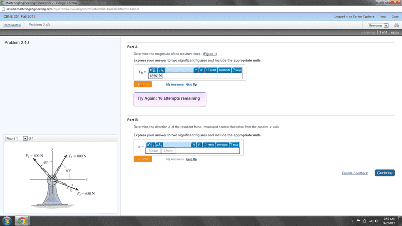

1. Homework Statement :
I keep attempting this problem and so far I have got this:
F1x: 150
F1y:260
F2x:424
F2y:424
F3x:600
F3y:250
Then I add the x's together and y's together, square both and take the square root for magnitude, but can't seem to get the right answer
F1= 800 N at 60 degrees, so F1x = 800cos(60) = 400 N. You have it as 150.

Well I tried again and I am running out of time..but here is my work:
F1x: 400
F1y:693
F2x:424
F2y:424
F3x:600
F3y:250
Fx's:1424
Fy's:1367
(1424^2+1367^2)^(1/2)
As far as how I found the x and y components I simply used the magnitude of the vector times cosine of the angle for x's and sine for y's...
I am very frustrated because this is such a simple problem and I don't see what else I would be doing wrong
What angles are you using for each force? Primarily F3?
Check the angle that you are using for F2. Are you sure you want to use 45 degrees?
Figured it out...and of course it was something stupid...I forgot to add the negatives to the numbers that needed it...I just figured I didn't need them since I was finding the magnitude anyways, but of course that affects the x and y resultant that you square
Exactly! Force is a vector so its direction matters ergo the sign also matters. I'm glad that you figured it out! :smile:
