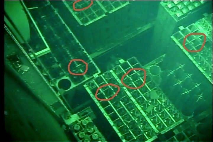

AntonL said:
and these solve the mystery of the "ballistic" fuel handling machinery in unit 3, submerged in SPF3
http://k.min.us/imMKhK.JPG
well , would be nice to get the video.. as is I'm not able to figure out what I'm looking at or rather how to relate it to other available material

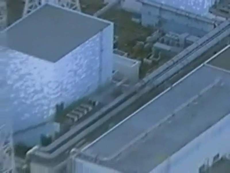

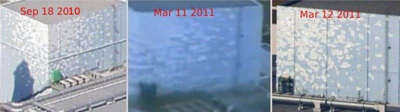

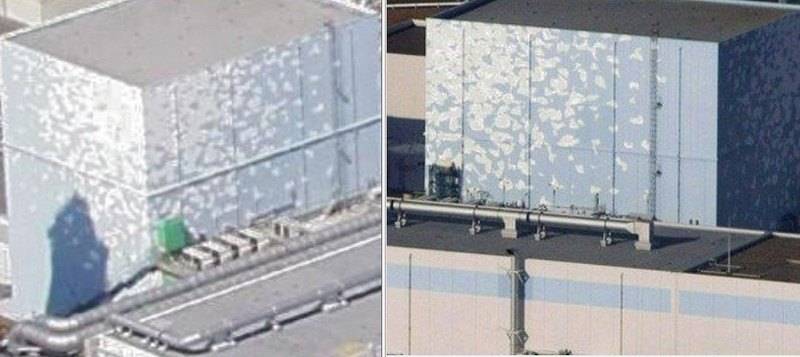

Dmytry said:
the same kind of explosion that blew all the wall panels from the floor 1 but left 2 out of 4 panels standing on floor 4? (western wall)
The top 2 rows of panels belong to the same storey. The floor level of that storey is the top edge of the reactor and of the SFP.

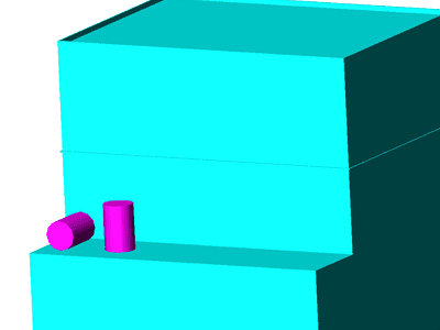

Dmytry said:
The kind of explosion that didn't happen where the crane is?
An object located near the "center" of a gas explosion presumably would be squeezed hard but not displaced by the explosion. Besides the roof frame of #4 was hardly damaged by the explosion (which blew through it); and the crane seems to be a lot heavier than that frame, even heavier and sturdier than the concrete pillars.
The naive impression I get looking at the building is that the main blast was on the level below the top floor. Could something else have blown up besides hydrogen? Are there any gas or fuel tanks on the 4th floor? Going back to the original (day of blast) speculation of lubricating oil fire, is lubricating oil explosive? (Maybe if it gets aerosolized for some reason?)
Seems hard to believe anything explosive would be present in a reactor building on purpose. Though, since the reactor was undergoing core shroud replacement, which apparently involves welding (according to the link given by MiceAndMen), might oxy-acetylene welding equipment have been temporarily located there?

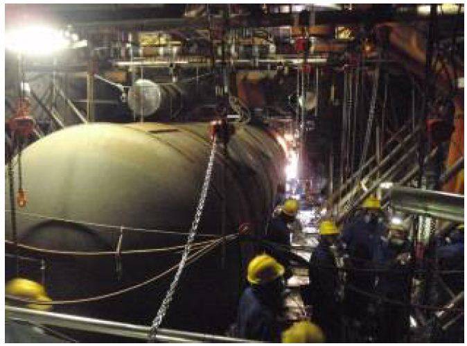

elektrownik said:
No way, explosion was too big for oil, this could be only steam and hydrogene. This is nuclear reactor and there is not much explosive things becouse it would be danger to keep them inside reactor building.
What about welding equipment for the core shroud replacement that was underway at the time? Acetylene tanks, for example?
  • #3,832
You wouldn't have enough acetylene in a welding tank to approach the lower ignition point based on the volume of that structure.
One large full welding tank at the most could handle about (guesstimate) 450 FT^3 of space. Much more then that and you'll have problems with ignition.

TCups said:
Hey Anton! I've got it! The FHM broke in two pieces and one of them fell back into the SFP! Amazing! :rolleyes:
This is what I also see. Could be like in a Hollywood movie.
