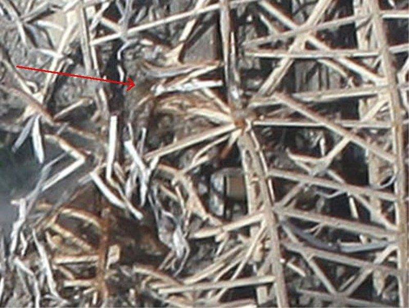

@AtomicWombat
Help me with this. If the FHM3 (or at least part of it) is still in SFP3, then what is(are) the large green object(s) that look as if they fell from the sky and smacked the northwest corner of building 3? Maybe the FHM did break up.
http://i306.photobucket.com/albums/nn270/tcups/Picture7.png
http://i306.photobucket.com/albums/nn270/tcups/Picture6-1.png And what might this large, curved, slab-like object that looks as if it hit an inner wall of Bldg 3 be? A "cookie"? Could the primary containment, once it "blew" not only have blown out the fuel transfer chute, but also, blown out some of the semi-circular portions of the "neck of the primary containment below the level of the service floor, and therefor, been the driving force in the blow out of the lower portions of Bldg 3 as well? We still have 3 booms to explain.
http://i306.photobucket.com/albums/nn270/tcups/Picture8-2.png
More and more questions.

TCups said:
Help me with this. If the FHM3 (or at least part of it) is still in SFP3, then what is(are) the large green object(s) that look as if they fell from the sky and smacked the northwest corner of building 3? Maybe the FHM did break up..
Part of the utility/dryer pool crane/machine
If so, how did it get lifted high enough in the air to come back down and do that kind of damage? If the mechanism of a steam explosion in the SFP3 is correct (I think so) and if the utility crane in Bldg 3 is "amidships" and the center section of the roof super structure is intact, as the photos show, and if only something over the SFP3 gets lifted vertically with enough oomph to go ballistic . . .
Could it be that either part of the FHM3 is still in the pool, or could it be that water added to the SFP3 causes the green color of whatever it is in the pool, or some combination of both?
Still more questions to be answered.

TCups said:
@AtomicWombat
I've been wondering if there is a separate crane/machine over the equipment pool in each building.
It looks like a piece of bent sheet metal to me.
I'm wary of drawing anything but tentative conclusions from image analysis, especially since we have no experience of working in these or similar plants.
It reminds me a little of seeing images of the aftermath of a bad car crash on TV. Often you can't work out the make and model of the cars involved let alone determine the details of what happened. On the other hand if you could sift through the debris personally you would probably be better able to form firm conclusions.
Look again, AW -- if it's sheet metal, it packed a helluva wallop where it look like it struck the inside wall. But yws, it could be something else -- maybe sheet metal. . .

I see more of a collapsed wall, by a lateral blast than a death from above damage, the last roof structure with wise has been bent toward north .
Tcup I'm not sure I understood you, In my opinion they are 3 cranes, 2 small for pool operations on big for slab, and shield handling.
