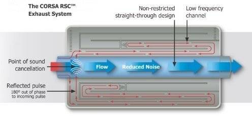

I don't see how this will work at all. Sound pressure is a scalar quantity, not a vector. It doesn't have a "direction" associated with it. The sound pressure in the flows that "meet in a 360 degree collision" (did you really mean 180 degrees?) after traveling equal distances around your teardrop shape will just add up, not cancel out.
If you want the sound pressure to cancel out at certain frequencies, you need to make two or more different path lengths, so the sound waves arrive out of phase with each other when they are mixed together. For example like this:
http://store.uucmotorwerks.com/technology-reflective-sound-cancellationrsc-c536.aspx
Likes 1 person
Hmmm... it appears you're right. So back to the drawing board for me.
Yeah, the gasses would meet 180 degrees out. The '360 degrees' was my attempt to explain that rather than it happening in just one plane as current mufflers do, it'd be in a complete circle.
Why do the muffler manufacturers put those V-shaped baffles in their mufflers? It splits then rejoins the exhaust stream, but since the sound waves constructively recombine, the net effect of those baffles would be zero, right? All it appears those baffles are doing is cancelling the velocity of the air stream, but the sound waves recombine and aren't dampened... exactly the opposite of what one wants from a muffler.
An "empty" cavity would give a strong resonance at particular frequencies. Apart from the noise, the pressure build-up at the resonant frequency could shorten the life of the muffler before a mechanical failure, or produce a high back pressure for the engine. With nothing to damp the resonance, the peak pressures at the resonant frequency could easily be 10 times the average exhaust pressure, or even higher. This might produce "dead spots" in the engine power curve when the RPM hit the resonant frequency.
Inserting angled baffles will tend to lower the resonant frequencies by making the sound waves travel a longer path through the chamber, and also absorb more of the sound because it is reflected more times from the baffles and walls of the chamber.
