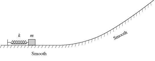

A box of mass m is pressed against (but is not attached to) an ideal spring of force constant k, compressing the spring a distance x. After it is released, the box slides up a frictionless incline as shown in Fig. 7.5 and eventually stops. If we repeat this experiment but instead compress the spring a distance of 2x:
A)Just as it moves free of the spring, the box will have twice as much kinetic energy as before.
B)Just before it is released, the box has twice as much elastic potential energy as before.
C)The box will go up the incline twice as high as before.
D)Just as it moves free of the spring, the box will be traveling twice as fast as before.
E)Just as it moves free of the spring, the box will be traveling four times as fast as before.
The weight and the normal force from the surface are balanced, so the only force acting on the box is the work done in compressing the spring = kx.
(Eq1) Hooke's Law: F = -kx
(Eq2) Conservation of Energy (no external work): Uo + Ko = U + K
(Eq3) Potential Energy of a Spring: (1/2)kx²
(Eq4) Kinetic Energy: (1/2)mv²
(Eq5) Potential Energy of Gravity: mgh
I've been able to prove choice B correct by doing the following:
Under compression length x:
(Eq1) F = kx
(Eq3) Us = (1/2)(F)x = (1/2)(kx)(x) = (1/2)kx²
Under compression length 2x:
(Eq1) F = 2kx
(Eq3) Us = (1/2)(F)x = (1/2)(2kx)(x) = kx²
thus, (1/2)kx² * 2 = kx², meaning the potential energy of the mass under compression length 2x is twice as large as the potential energy of the mass under compression length x. Proving choice B correct.
However, I'm having trouble proving the other one's incorrect, especially choice C and choice D because I'm looking at the problem as two parts:
  1. Potential energy of the mass compressed on the spring TO kinetic energy just before release by spring
  2. Initial kinetic energy of just released mass TO final potential energy of mass up ramp
So,
(Eq2) Uo = K (no initial kinetic because mass is compressed on spring with no movement, no final potential because this is only up to mass release by spring)
(Eq3, Eq4) (1/2)kx² = (1/2)mv²
v² = kx²/m
Now we switch to part 2, where the mass has been just released from the spring (initial kinetic, no potential) to final position on ramp (final potential, no kinetic)
(Eq2) Ko = U
(Eq3, Eq5) (1/2)m(kx²/m) = mgh
(1/2)kx²/mg = h
(Eq3, Eq4) kx² = (1/2)mv²
v² = 2kx²/m
(Eq2) Ko = U
(Eq3, Eq5) (1/2)m(2kx²/m) = mgh
kx²/mg = h
Here is the problem: With the height ho = (1/2)kx²/mg under compression length x and h = kx²/mg under compression length 2x, this implies 2ho = h, which proves choice C.
So, I don't know if choice B or choice C is right. If someone can help me clarify this, I would greatly appreciate it. I've been at this for hours.
as you say, PE depends on the square of the compression (½kx^2)
what happens when you square of the new compression , "2x" ?
is the Work done, and the PE stored, 2x as big as before?
(not only is the max Force 2x as strong, but the distance is also 2x as far)
Okay, I'll recheck some things.
Yes, B is incorrect. The hint was that it is the SPRING which has elastic PE, not the box.
So it must be that the box goes higher, or leaves the spring faster ... (c,d,e)
