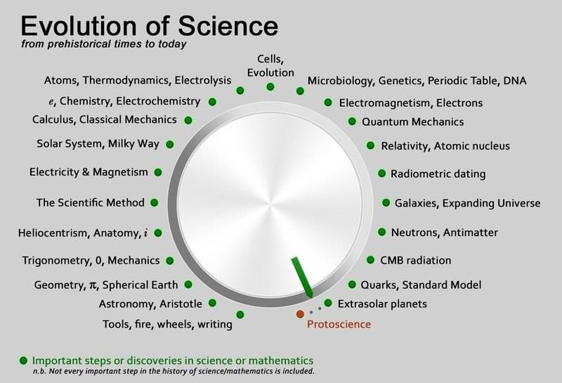

Hi PF members!
I've recently been working on an image (see attached thumbnail) in which I try to include the most important/influential steps in the history of science. Now, I am very well aware that this is not easy (!) :smile:, and it will always be debatable and not without controversy; history is not easy, dating is not easy, the development of science is not linear and seldom depends on a small group of people. Nevertheless I have tried to follow these rules concerning every step in my image;
I essentially ignore any early ideas and theories on different matters, even if they were correct, and try to focus on
a) when an important scientific paradigm/theory can be considered to emerge/mature/become useful/widespread, or
b) when a hypothesis becomes confirmed,
c) balancing both macroscopics and microscopics
d) I've excluded inventions and technological advances (except tools/fire/wheel/language, they are only there as a placeholder for very early science)
Since the image has 22 placeholders I am forced to make decisions on which things to include/exclude, and this is always hard. Please note that I am aware that I have excluded many things. The image is intended to include the steps which are on the absolute frontline of science at that time, steps which dramatically expand that frontline and contribute greatly to the scientific knowledge. In other words, things that have crucially changed/improved science and/or the worldview.
I post this here on PF to get input from others, since I know there are lots of people with different knowledge here. What I would like to get feedback on is the following;
Are there any concepts not present in the image which can be considered important enough to include?
The criterion for inclusion should be that a concept should be so important that it almost could kick out another concept in the image. I am able to squeeze in a couple of more concepts, depending on when they occurred/where they'll fit in layout-wise (there is currently one empty placeholder). I'm thinking of perhaps e.g. biology/medicine; the image is rather weak in these areas.
I am interested what people have to say about the image, and I am open for suggestions, so any thoughts?
n.b. there will probably be some graphical changes made to the image, e.g. nicer background/faded images. The image will later be available as CC or public domain. I also post my compiled timeline below, as help;

It seems a bit odd to start a history of science before the scientific method. I'd suggest including the paradigms of discovery before this too.
Quick specific point: Watson, Crick and Franklin together determined the double helix structure of DNA, they didn't discover it.
Thanks Ryan!
Scientific method; yes, this was actually the absolutely toughest topic for me to consider, since it has evolved over a long period of time. I selected the time of Francis Bacon during the scientific revolution. But maybe it would be better to choose something earlier? I'll ponder on it, and also hope to get more feedback.
DNA; good spotting, I'll definitely fix that. I suppose you mean Friedrich Miescher 1869? EDIT: new image with moved DNA.
I lost my internet connection while originally making a post here, so I have lost my motivation to retype it all :(
Basically, Watson, Crick, and Wilkins were awarded the Nobel Prize for their working model of the DNA double helix. They used evidence from people like Rosalind Franklin (who crystalized DNA and diffracted light through it to observe its pattern) to formulate their model. Franklin died before the Nobel Prize was awarded, otherwise she more than likely would have shared a part of the prize, considering Wilkins role in the model was that he helped Franklin with some of her further diffraction experiments.
I also would recommend that you check out George Sarton. Good luck!
One might add in Dirac (1928) for his idea that electrons could have positive charge, and Carl D. Anderson, who discovered the positron on August 2, 1932. Basically confirming anti-matter. It would be some time before anti-protons were produced. Dirac alluded to anti-protons in his Nobel lecture (1933). http://www.nobelprize.org/nobel_prizes/physics/laureates/1933/dirac-lecture.pdf
The antiproton was experimentally confirmed in 1955 by University of California, Berkeley physicists Emilio Segrè and Owen Chamberlain, for which they were awarded the 1959 Nobel Prize in Physics. http://www.nobelprize.org/nobel_prizes/physics/laureates/1959/
Astronuc, thanks! Definitely worthy of inclusion, IMO. How come I forgot that...? :) EDIT: new image.
I don't really see why you consider the number "e" to be very important. Surely it is important, but there are things in mathematics which were far more important and revolutionary. An obvious omission is (for example) the discovery of non-Euclidean geometries and differential geometry.
I think one would have to have a parallel history of mathematics and perhaps mathematical physics, since they go hand-in-hand.
Somewhere I remember seeing a timeline chart of developments in mathematics, chemistry and physics, and a similar timeline of human developments separated geographically. It's interesting to see the parallels.
DennisN said:
240 Earth is a sphere (Eratosthenes)
1543 Heliocentrism (Copernicus' Revolutionibus, later Galileo)
Nope,
3rd century BCE Aristarchus.
It was just forgotten for a while. Notice that he also had some notion of the galaxy.
You (King Gelon) are aware the 'universe' is the name given by most astronomers to the sphere the center of which is the center of the Earth, while its radius is equal to the straight line between the center of the Sun and the center of the Earth. This is the common account as you have heard from astronomers. But Aristarchus has brought out a book consisting of certain hypotheses, wherein it appears, as a consequence of the assumptions made, that the universe is many times greater than the 'universe' just mentioned. His hypotheses are that the fixed stars and the Sun remain unmoved, that the Earth revolves about the Sun on the circumference of a circle, the Sun lying in the middle of the Floor, and that the sphere of the fixed stars, situated about the same center as the Sun, is so great that the circle in which he supposes the Earth to revolve bears such a proportion to the distance of the fixed stars as the center of the sphere bears to its surface.
Thanks for your feedback!
I agree. I fitted in e since it doesn't take up much space in the image, and also to have at least some sort of representation of exponentiation/logarithms. I definitely considered non-Euclidean geometry, but I could not fit it in the image :frown:.
Actually I am thinking of making another similar image for mathematics only :smile:. This first image is intended to be more of a general science/physics image, with some basic math concepts included.
Andre said:
Nope, 3rd century BCE Aristarchus. It was just forgotten for a while. Notice that he also had some notion of the galaxy.
Yes, but for spherical Earth I followed this rule; b) when a hypothesis becomes confirmed. AFAIK Eratosthenes did the first known validation of the hypothesis. Heliocentrism; I chose Copernicus because his publication sparked the subsequent work by others (e.g. Kepler, Galileo) which jointly confirmed the model. I'd prefer choosing a validation year, but I can't decide which one to choose, since there was a number of different observations which together led to the acceptance of heliocentrism.
Anyway, thanks for feedback, much appreciated! I'm still thinking of how to handle the scientific method, which Ryan mentioned. And I am still pondering here and there, so I am open for continued feedback. E.g. one thing I am considering is replacing neutrons with quantum field theory, perhaps.
e, i, pi, 0, 1
which number is the least important? the most important?

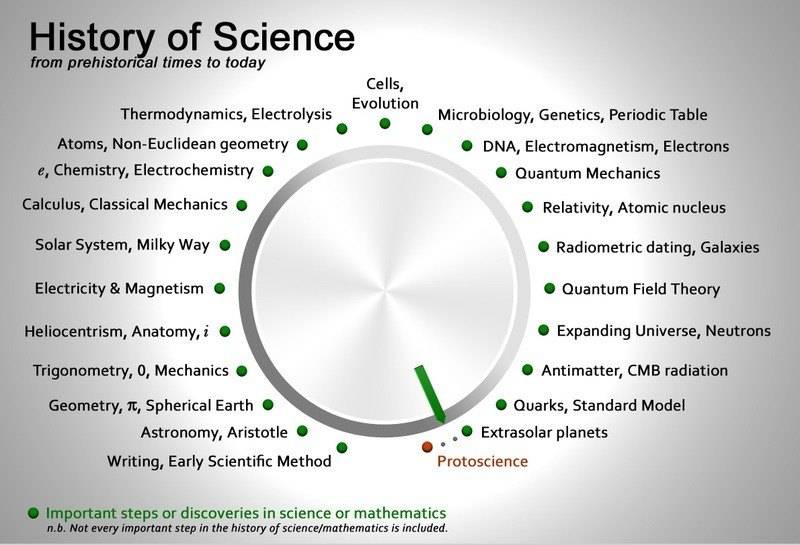

Thanks to the feedback here, I've got a new version of my image which I'm more pleased with. I've omitted tools, fire, wheel and went for "early scientific method" (Edwin Smith papyrus). I've squeezed in non-Euclidean geometry since it is an important paradigm shift from previous geometry. I've also squeezed in quantum field theory, while managing to keep neutrons, which I did not want to omit.
I'm still open for feedback if anyone feels like it (I also post my updated timeline).

SteamKing said:
e, i, pi, 0, 1, which number is the least important? the most important?
I wouldn't compare them.:smile:
EDIT: I noticed it says "from prehistorical times..." in the title. Obviously incorrect, since I start with "Writing", so I have to find a more suitable word.

Not so sure about pi as a separate entry. Perhaps Archimedes might be more fittingly remembered for the method he used to determine pi or his works on hydrostatics and statics.
Napier (1614) might be a better starting point for logarithms than e. http://en.wikipedia.org/wiki/John_Napier
His work, Mirifici Logarithmorum Canonis Descriptio (1614) contained fifty-seven pages of explanatory matter and ninety pages of tables of numbers related to natural logarithms. The book also has an excellent discussion of theorems in spherical trigonometry, usually known as Napier's Rules of Circular Parts.
Thanks NemoReally!
Neither am I :smile:. It was basically the same thing with pi as with e, I fitted them in partly because they're so common in science/math and since they take up so little space in the image. But I could omit pi and consider it somewhat represented by "geometry".
Yes, I agree with this too. I will ponder upon Archimedes.
Definitely. I did consider exactly what you are suggesting, but omitted logarithms because I rather wanted to fit in physics. But now I'm thinking of including logarithms...:smile:
Thanks for your feedback, I will make further changes, but I must think it through first. And I am open for continued feedback, so I'm thankful for any suggestions.
There are always things that are pretty important that have to be left out. Have you got to the point where for everything you put in you throw something out? You seem to have thrown out double-helix DNA (Watson-Crick). I think that is a mistake, there are things there that though important are indubitably less important. The structure threw strong light on the function but you haven't got anything on the discovery of the function: Miescher is just shrewd suspicion, how about Griffith, Avery, Hershey?
You haven't got anything for organic chemistry, nor X-rays, nor the atomic/molecular structure of matter Laue, Friedrich, Knipping, Braggs. If this has to all fit on a postcard I guess it's impossible.
I wouldn't agree that for something to be part of the History of Science it has to have fit into some present-day official formulation of The Scientific Method :bugeye: - take no notice of such exhortations! :biggrin:

Yes, basically, but I'm not yet finished so I am still open for suggestions. I posted it here to get feedback.
epenguin said:
You seem to have thrown out double-helix DNA...[]...how about Griffith, Avery, Hershey?
You make a good point. The function of DNA would probably be a more suitable entry than the discovery. So I think I'll use Griffith, or what do you think?
Also good points. I think molecules deserves an entry, and I will think about organic chemistry. I'll study up on the history of it, thanks!
Yes. It's far from a definitive history, it's just a brief history. But I'm thinking of replacing Electrochemistry and Electrolysis with Molecules and Organic Chemistry; the image already has a fair representation of "electrostuff". So I am definitely considering your suggestions, I think they are good, thanks!
But then the nature of ordinary matter is electrical, second layer of the onion, so that is hard to discard.
Now I've done a new version of the image, and I'm starting to get really pleased (I'm still open for feedback though - there's a placeholder line free atm). I had serious problems with deciding on a suitable entry for "Molecules", but finally I decided to go for Amedeo Avogadro (1811). Pi and e is still present, I wonder if anyone will object? :smile: I've also decided to make two final images when I'm done; one small and one large with a complete timeline below the "science knob".
Changed entries:
  • Anatomy (Andreas Vesalius' De humani corporis fabrica, 1543) got omitted. I needed space, and the entry was pretty dubious anyway.
  • Logarithms added (John Napier, 1614).
  • Solar System - now omitted. It was a really dubious entry - when can the Solar System be considered to have been discovered, really? :confused:
  • Chemistry got merged with Electrochemistry (1764-1800), this made some new space.
  • Molecules added (Amedeo Avogadro, 1811).
  • Organic Chemistry added (Friedrich Wöhler, Wöhler synthesis, 1828).
  • Electrolysis (Faraday, 1832) got omitted. Sorry, Faraday, I needed space.
  • DNA got moved to 1944 (Alfred Hershey, Martha Chase confirms the genetic role of DNA).
  • Atomic structure added (William Bragg(s) discovers diffraction of X-rays by crystals, 1912).
New timeline:
BCE
3200 Writing (language writing, ancient Sumer)
1600 Scientific method (Edwin Smith papyrus, ancient Egypt; examination, diagnosis, treatment, and prognosis)
1200 Astronomy (ca, early Babylonian star catalogues)
330 Aristotle (early corpus of science)
300 Geometry (Euclid's Elements)
250 Pi (ca, polygon approximation, Archimedes)
150 Trigonometry (Hipparchus)
CE
458-498 Zero as a number, decimal place notation (Aryabhata)
1100 Early mechanics (various islamic/arab scientists)
1543 Heliocentrism (Nicolaus Copernicus' Revolutionibus, later Galilei)
1572 Imaginary numbers (rules of, Rafael Bombelli)
1600 Electricity & Magnetism (William Gilbert)
1610 Milky Way (Galileo Galilei)
1614 Logarithms (John Napier)
1660 Calculus (ca, Isaac Newton, Gottfried Leibniz)
1687 (Classical) Mechanics (Principia, Isaac Newton)
1736 e (the base of the natural logarithm, Leonhard Euler's Mechanica (1736))
1764-1800 Chemistry (Antoine Lavoisier), Electrochemistry (Volta, 1800)
1803-1805 Atoms (Atomic theory, John Dalton)
1811 Molecules (start of Molecular theory, Amedeo Avogadro)
1823 Non-Euclidean geometry (ca, start of work, Nikolai Lobachevsky/János Bolyai)
1824 Thermodynamics (Nicolas Carnot)
1828 Organic Chemistry (Friedrich Wöhler, Wöhler synthesis (1828)
1839 Cells (Cell theory, Theodor Schwann, Matthias Schleiden)
1859 Evolution (Charles Darwin, Alfred Wallace)
1860-1880 Microbiology (Ferdinand Cohn, Louis Pasteur, Robert Koch)
1866 Genetics (Gregor Mendel)
1869 Periodic Table (Dmitri Mendeleev)
1887 Electromagnetism (James Maxwell, Heinrich Hertz)
1897 Electrons (J.J. Thomson)
1900 Quantum Mechanics (Max Planck et al.)
1905 Relativity (Albert Einstein, Special (1905), General (1916), Kennedy–Thorndike experiment (1932))
1909 Atomic nucleus (Ernest Rutherford)
1911 Radiometric dating, Arthur Holmes' first accurate dating (Rutherford suggestion (1905), Radioactivity (Henri Becquerel, 1896))
1912 Atomic structure (William Bragg(s) discovers diffraction of X-rays by crystals)
1922-1924 Galaxies (Edwin Hubble conclusively discovers galaxies outside Milky Way)
1927 Quantum Field Theory (Paul Dirac works on quantum electrodynamics)
1929 Expanding Universe (Georges Lemaitre proposes expansion, Big Bang (1927), Hubble confirms expansion (1929))
1932 Neutrons (Feb 27, James Chadwick)
1932 Antimatter (Aug 2, Carl D. Anderson (discovery of positron), suggestion by Dirac (1928))
1944 DNA (Alfred Hershey, Martha Chase confirms the genetic role of DNA)
1964 Cosmic microwave background radiation (Arno Penzias, Robert Wilson)
1968 Quarks, Standard Model (ca, SLAC, Murray Gell-Mann, George Zweig et al.)
1988 Extrasolar planets (Bruce Campbell, G. A. H. Walker, Stephenson Yang)
Now
(Protoscience)
I've continued to work on the timeline/image (small/big version), and I will probably upload a new version today. Some more things have been rearranged; hopefully I'm getting close to the finished version :tongue2:.
It seems the more I dig myself into the history, the harder it gets. I have to start digging myself out now :biggrin:. There are still some people/fields I'd like to include, but they haven't found their place yet, like Hippocrates and Michael Faraday. Maybe they'll get into this image, I don't know.
It's been pretty interesting to dig into the history like this. I'd like to say some things I've noticed during my work with this thing; I already knew history isn't easy, but I was nevertheless astonished by the complexity of the history of science I encountered when I dug into the stuff.
I find the history of physics relatively easy, which is probably partly due to my particular interest in physics. But, gosh, I think the history of chemistry & biology seems really complex, there are so many different things connected to so many different people.
I also noticed that the history of math does not seem to be as easy as I thought; I noticed this when I looked into logarithms, e and complex numbers - it is almost like a long complex string of knots; one person contributes to a field in one place and ties a knot on the string, another person ties another knot somewhere else, and later, someone else ties the knots together. So it can be quite hard to build a coherent description of the history - which I somewhat fear since I'm thinking of digging into math history later :).
One other interesting thing which surprised me was the many profoundly important contributions that were made during the 1800s. I find the development of chemistry and biology during this century truly impressive.
Also, there is one short period which astonishes me in particular: 1896-1912. In 17 (seventeen!) years the world saw the discoveries of the atomic nucleus, subatomic particles, atomic structure, radioactivity, radiometric dating + quantum mechanics (!) + relativity (!). I find this short period simply outstanding!
I'm working on the layout (I've got some layout problems I have to solve), but I post an intermediate version here, since I've done a major revision of the timeline (the timeline is present in the attached picture, and as text in the post below).
I've managed to squeeze in more stuff, and I even have place for maybe 3-4 more concepts at the moment. So feedback is still welcome :smile:.
One concept I am considering to include is abiogenesis (the Miller–Urey experiment) - any thoughts on this? Can it be considered important enough to include in this image?
Changed/added entries;
  • 400 BCE; added Hippocrates and the Hippocratic School of Medicine build the foundations of western medicine (c.)
  • 300 BCE; added Optics (Euclid's Optics, ca 300 BCE)
  • 287-212 added Archimedes (ca, Archimedes works on statics, hydrostatics, mathematics, pi etc)
  • omitted (early) mechanics from ca 1100 (various islamic/arab scientists), since Archimedes got into the list and classical mechanics got shortened to mechanics (space saving)
  • 1543; readded Anatomy (Andreas Vesalius' De humani corporis fabrica, published in Aug 1543, it IS an important work)
  • 1674 added Microbiology; Antonie van Leeuwenhoek discovers bacteria and other microorganisms (1674-1676)
  • 1800; readded Electrochemistry; Alessandro Volta invents the first electrochemical cell producing electric current due to chemical reactions
  • 1820; added Electromagnetism; Hans Christian Ørsted discovers a direct relation between electricity and magnetism when an electric current deflects a compass needle
  • retitled Microbiology -> Bacteriology (Cohn, Pasteur, Koch)
  • 1896; added Radioactivity; Henri Becquerel discovers spontaneous radioactivity by accident
  • retitled Electromagnetism -> Electromagnetic radiation
  • finally omitted pi and e; historically, they were pretty dubious entries anyway (and e ≈ pi ≈ 3 anyway ≈ 0 :D)
  • Expanding Universe -> Big Bang; I don't like the BB word, but it saved space. Ironic, since BB is an expansion of space...
  • Protoscience changed to "?" - more interesting, eh? This also gave me a whole new line.
  • I've written better descriptions in the timeline
  • I've done some corrections of years in the timeline
Here's the current timeline in text;
BCE
3200 Writing - Langauge writing appears in Sumer (c.)
1600 Scientific method - The Edwin Smith Papyrus from Egypt describes examination, diagnosis, treatment, and prognosis (c.)
1200 Astronomy - Early star catalogues are compiled in Babylonia (c.)
400 Medicine - Hippocrates and the Hippocratic School of Medicine build the foundations of early western medicine (c.)
330 Aristotle - Aristotle writes various scientific texts (c.), later compiled into Corpus Aristotelicum
300 Geometry & Optics - Euclid writes Elements and Optics (c.)
260 Archimedes - Archimedes works on statics, hydrostatics, mathematics, pi (c.)
240 Spherical Earth - Eratosthenes performs the first calculation of the circumference of the Earth (c.)
150 Trigonometry - Hipparchus compiles the first known trigonometric table (c.)
CE
458 Zero as a number - The Indian text Lokavibhaga describes a numeral zero and decimal place notation (c.)
1543 Heliocentrism - Nicolaus Copernicus' On the Revolutions of the Heavenly Spheres is published in March 1543
1543 Anatomy - Andreas Vesalius' On the fabric of the human body is published in August 1543
1572 Imaginary numbers - Rafael Bombelli’s Algebra is published, describing the first rules of complex numbers
1600 Electricity & Magnetism - William Gilbert's On the Magnet and Magnetic Bodies is published
1610 Milky Way - Galileo Galilei’s Sidereal Messenger is published, describing the Milky Way as composed of stars
1614 Logarithms - John Napier’s Description of the Wonderful Rule of Logarithms is published
1666 Calculus - Isaac Newton and Gottfried Leibniz develop infinitesimal calculus (c. 1666-1684)
1674 Microbiology - Antonie van Leeuwenhoek discovers bacteria and other microorganisms (1674-1676)
1687 Classical mechanics - Isaac Newton’s Mathematical Principles of Natural Philosophy is published
1789 Chemistry - Antoine Lavoisier’s Elementary Treatise of Chemistry is published
1800 Electrochemistry - Alessandro Volta invents the first electrochemical cell producing electric current due to chemical reactions
1808 Atoms - John Dalton’s A New System of Chemical Philosophy is published, describing a modern atomic theory
1811 Molecules - Amedeo Avogadro’s essay “Elementary Molecules” is published, describing Avogadro's law
1820 Electromagnetism - Hans Christian Ørsted discovers a direct relation between electricity and magnetism
1824 Thermodynamics - Sadi Carnot’s Reflections on the Motive Power of Fire is published
1828 Organic chemistry - Friedrich Wöhler discovers the Wöhler synthesis, i.e. synthesizing urea from ammonium cyanate
1829 Non-Euclidean geometry - János Bolyai (1832) and Nikolai Lobachevsky (1829) publish works on Non-Euclidean geometry
1837 Cells - Theodor Schwann and Matthias Schleiden develop cell theory (c. 1837-1839)
1859 Evolution - Charles Darwin’s On the Origin of Species is published, Alfred Wallace contributes to the theory
1860 Bacteriology - Ferdinand Cohn, Louis Pasteur and Robert Koch work on microbiology (c. 1860-1880)
1866 Genetics - Gregor Mendel’s Experiments on Plant Hybridization is published, describing Mendelian inheritance
1869 Periodic table - Dmitri Mendeleev creates a periodic table with elements ordered by atomic mass
1887 EM radiation - Heinrich Hertz conclusively discovers electromagnetic radiation, confirming James Maxwell’s theory from 1865
1896 Radioactivity - Henri Becquerel discovers spontaneous radioactivity by accident
1897 Electrons - J.J. Thomson discovers the electron
1901 Quantum mechanics - Max Planck’s On the Law of Distribution of Energy in the Normal Spectrum is published
1905 Relativity - Albert Einstein’s On the Electrodynamics of Moving Bodies is published (special relativity), general relativity (1916)
1909 Atomic nucleus - Ernest Rutherford discovers the atomic nucleus
1911 Radiometric dating - Arthur Holmes performs the first accurate radiometric dating
1912 Atomic structure - William Bragg and William Bragg discover diffraction of X-rays by crystals
1922 Galaxies - Edwin Hubble conclusively discovers galaxies outside the Milky Way (1922-1924)
1927 Quantum field theory - Paul Dirac works on quantum electrodynamics
1929 Big Bang - Edwin Hubble confirms expansion of the Universe (”Big Bang”), proposed by Georges Lemaitre in 1927
1932 Neutrons - James Chadwick discovers the neutron in February 1932
1932 Antimatter - Carl D. Anderson discovers the positron in August 1932, confirming Dirac’s prediction of “anti-electrons” in 1931
1944 DNA - Alfred Hershey and Martha Chase confirm the genetic role of DNA
1964 CMB radiation - Arno Penzias and Robert Wilson discover the cosmic microwave background radiation
1967 Quarks, Standard Model - Jerome Friedman, Henry Kendall and Richard Taylor et al. confirm quarks at SLAC (c. 1967-1973)
1988 Extrasolar planets - Bruce Campbell, G. A. H. Walker and Stephenson Yang discover the first extrasolar planet
You mention it in your Hertz entry, but Maxwell ought to have his own entry. His publication of Maxwell's equations had a MAJOR effect on the world of science in the last half of the 19th century.
Thank you! Yes, I agree with you; also, the timeline has been quite expanded since the first version, so Maxwell ought to get his own entry, and he will.
I spotted an error in my timeline above;
"DNA - Alfred Hershey and Martha Chase confirm the genetic role of DNA" should be 1952, not 1944; it was probably some weird mix-up of these years in my notes:
Avery-MacLeod-McCarty experiment (published 1944)
Hershey–Chase experiment (published 1952)
