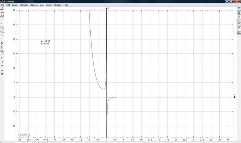

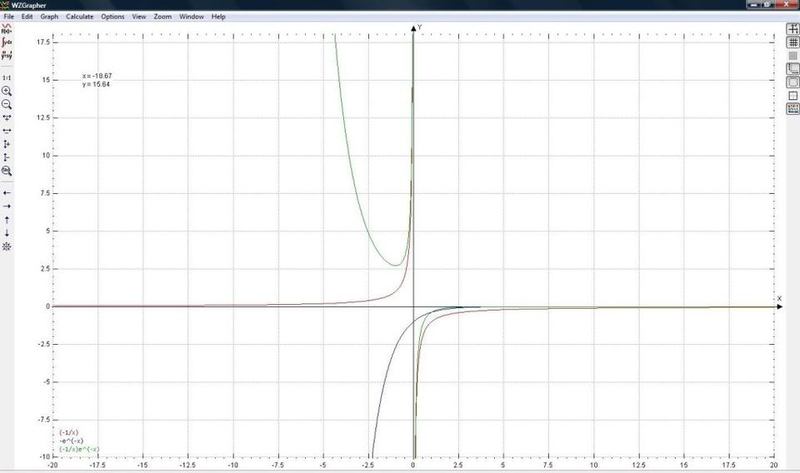

Yukawa Plot:
I plotted the three functions as suggested, and using the software suggested, this is a plot of them:
(nb1: apologies, can't figure out how to make the images smaller.)
(nb2: had to use x as variable not r, it wouldn't let me plot it otherwise)
So the Yukawa Potential should look like this:
.. yes?
I) You don't need to plot negative 'r' since the radius is from 0 to infinity.

1. OK so on that second graph, which will be the one I actually use and sketch to represent the Yukawa potential, there only needs to be the right hand side of it yes? i.e. only need the line going from [itex]y = -\infty[/itex] to [itex]x = \infty[/itex]?
