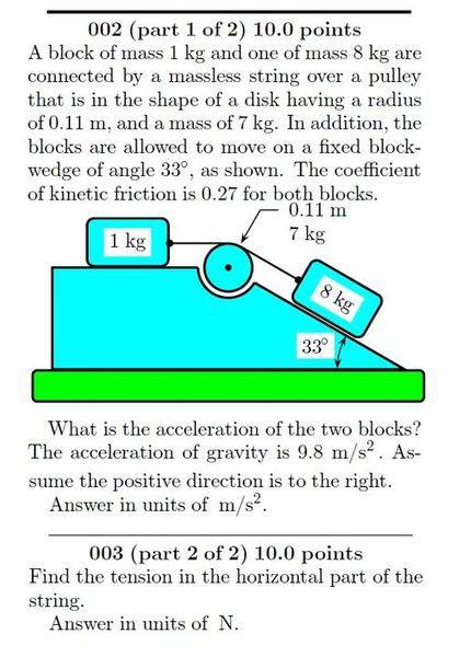

Acceleration of masses connected with string, non massless pulley

m1 = 1 Kg
m2 = 8 Kg
[tex]\theta[/tex] = 33 degrees
mpulley = 7 Kg
rpulley = .11 m
[tex]\mu[/tex] = 0.27
g = 9.8 m/s2
My attempt, I'm falling behind in class due to an illness and I can figure this out as long as the pulley is massless and frictionless but I'm not sure what do with the pulley. I missed that day. If I can get an idea as to what do with it the rest of the problems should make sense, thanks for the help.

I assume that because they are connected by an string a1 = a2?
is my assumption still correct with a non-massless pulley? also for the block on the incline
I put the x-axis along the incline
[tex]\Sigma[/tex]Fx = m2gsin[tex]\theta[/tex]- T - f2
Also is my assumption correct that the tension in the string (T) should still be the same on both sides of the pulley?

I added the equations together (T's cancel)
m2gsin[tex]\theta[/tex] - T + T - f2 - f1 = (m1 + m2)a
(8.0)(9.8)sin(33) - (21.168) - (2.646) = 9.0a
a = 6.0643 m/s2
This is obviously not the correct answer, plus I didnt use the pulley information at all..

1) How does the pulley factor into this?
2) Is the tension in the string still the same on both sides of the pulley?
3) Is the acceleration of both blocks still the same because they're connected by the string?
4) am I even going in the right direction with how to solve this?

1) The pulley needs some torque to accelerate its rotation.
2) No, the tension is different on the both sides of the pulley and the difference of the torques will accelerate the rotation of the pulley
3) Yes.
As there is no mention about the friction between the string and pulley, it can be assumed big enough so as the string does not slip. If so, the linear speed of the rim of the pulley is the same as the speed of the string, so v=ωR.
4) For m2, the component of gravity along the slope (and string) is m2gsinθ, and the normal component is N= m2g cosθ.
You have two write equations also for the pulley.

Both tensions produce a torque, they are of opposite sign and the net torque is equal to Iα.
