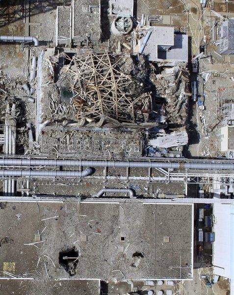

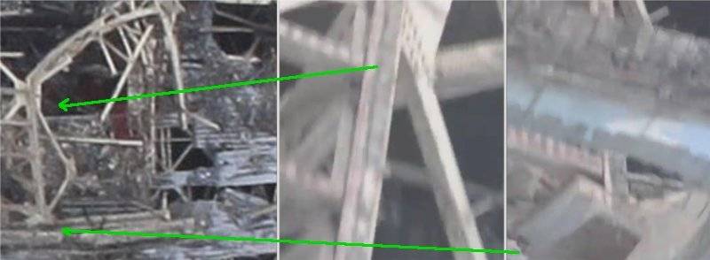

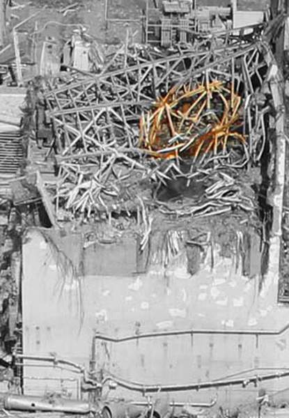

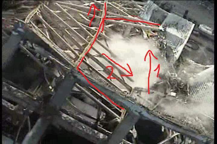

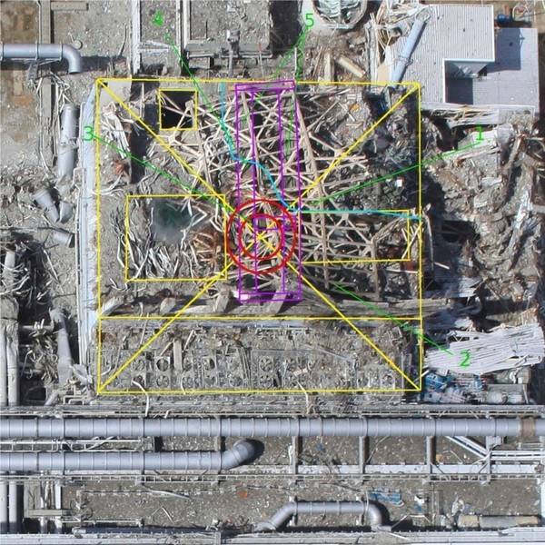

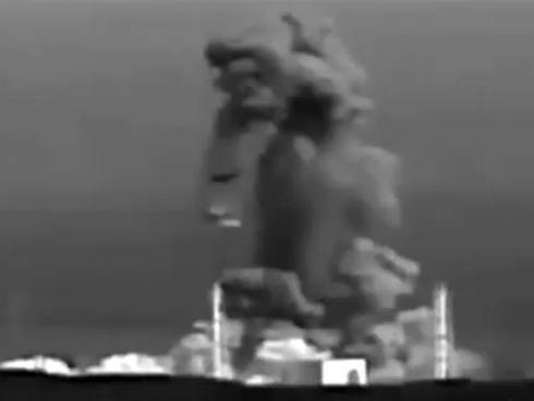

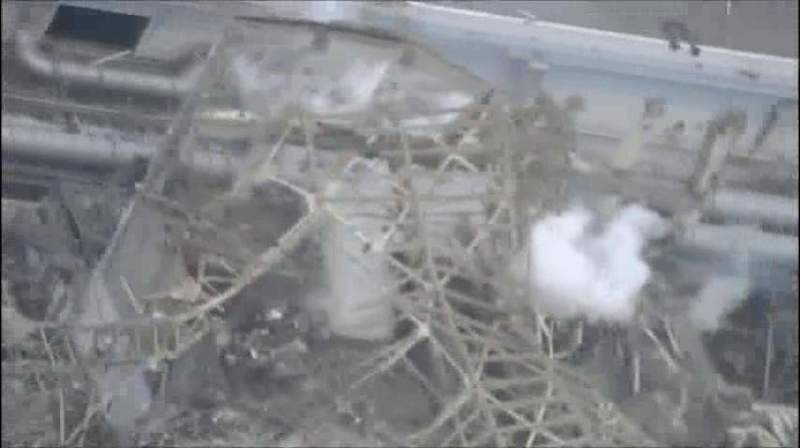

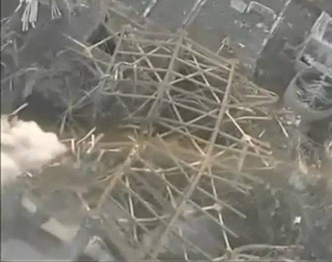

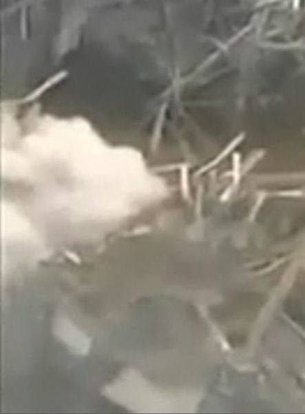

Correct me if I am wrong but, analyzing the previous posts (#2978-#3500 excluding https://www.physicsforums.com/showpost.php?p=3232444&postcount=3058" at page 21 , the design pressure of the containment is 4-5 bar instead of one pressure's probability up to 8 bars. Almost doubled!, (even after the released of hydrogen from RPV).
Due to this release of hydrogen into the building 3, the normally separated ambients, are in strictly contact for a fire propagation.
This explosion had disintegrated the upper part of the containment structure and, due to one de-pressurizzation of the Reactor Pressure Vessel (RPV), aspirated some particles of heavy materials in the air.
