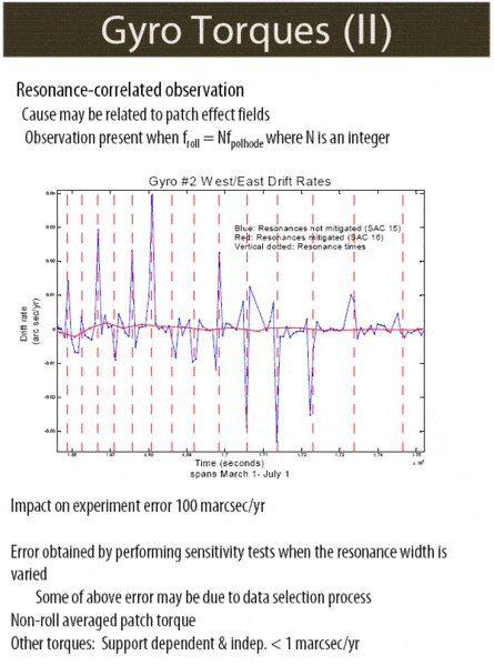

Garth – Thank you for your thoughts. Unfortunately, they do not address the recently reported concerns of the GP-B team “…sources of noise and interference that are buried in the data, along with the relativity signals” (Feb 9th release). As you know, these need to be separated out to find the GR effects. So while I applaud your efforts to keep this thread focused on the GR effects, let us be aware that the other data picked up by GP-B needs to be understood as it may well be of fundamental importance to this topic. This is the reason that Glen and I and others have “speculated” about possible other motions or contributing factors.
It is clear we disagree about the solidity of current precession theory. You may be right that it is well modeled but not from first principles. Consequently, I do not share your confidence that the effect of a hypothetical companion would be limited to .5”p/y. If much of what we call the precession observable turns out to be primarily the geometric effect of a solar system in motion then it would skew this number radically. Nonetheless, I recognize your traditional viewpoint and agree this must be given first consideration until such sources of “…noise and interference…” can be properly understood. But let us keep in mind that those unexpected signals may be hinting at something we don’t know.
Garth, you have been very supportive of GP-B and party line physics and I sincerely respect your opinions. So give me your best guess: Now that we know there is noise beyond the polhode issue, what do you think is the source of that “…noise and interference…”?
Walter
  • #85
Walter

  • #86
Indeed the other sources of noise and interference have to be understood, but these are affecting the smallest margins of error at the less than 1 milliarcsec/yr level. That is why the proper motion of IM Pegasi, relative to the distant quasar, had to re-assessed at that same level.
As I have said, I don't understand your reasoning. If the solar system is orbiting a solar binary companion, which has to be far enough away not to drastically perturb planetary orbits, it would not show up in the precession of the equinoxes, except at that small (< 1 milliarcsec/yr) level. The line of nodes of the intersection of the ecliptic and celestial equator would point to the same distant quasars, and measured against ordinary local stars would show a small precession of galactic coordinates (due to the Sun orbiting the galactic centre) and those local stars' differential galactic rotation described by the Oort constants. If the hypothetical binary companion was actually observable then it would be seen to move at the system's orbital rate relative to the fixed stars.
The interference, I surmise without yet seeing the GP-B's team analysis, might come from the interaction of the SQUIDs measuring the London effect on the cryogenic gyroscopes' surfaces, from non-inertial forces acting on the spacecraft , drag and thruster leakage, radiation pressures from both external and internal sources and the like.
What is really important is for these 'noises' to be understood correctly and corrected for to reveal the pure relativistic signal, which will yield the answer to the question: "Exactly how is a vector (the gyroscopes' spin axis) parallel transported through the space-time around a rotating Earth in polar orbit around the Sun?"
At a higher level of accuracy (smaller error) the rotation of the Sun about a hypothetical companion could also influence this answer as well as the whole system's rotation around the galaxy.
Periodicities would be important in separating out these various sources of space-time curvature.
The final result is anybody's guess at the moment, so the present question is: "Are the GP-B results consistent with the GR predictions, or with one of the alternatives, or with something completely different (as in F H-C's 'rotating inertial compasses' scenario)?"
As I have said there have been other ways of making the geodetic and frame dragging measurements, such as the dynamics of the double pulsar, but these have theoretical degeneracies in them, so the question is still open.
Not long now to find out!
Garth
  • #87
Do you know for a fact that the unknown signals are less than 1 milliarcsec? That would be good news for GPB. I understand that is the hope and expectation but was there an actual press release that said that? Did I miss something?
Walter
  • #88
Walter
Walter from the most recent GP-B website Status update as of 9 February 2007.
Now that the gyro polhode behavior is well understood, we have been able to shift our focus to identifying and addressing some subtle systematic sources of noise and interference that are buried in the data, along with the relativity signals. Identifying and removing as many of these subtle systematic effects as possible is critically important for reducing the margin of error in our final results—especially the frame-dragging result. While we have been making steady progress in these efforts, it has proven to be a slow and painstaking process, and it is now apparent that several more months of data analysis will be required to achieve the lowest possible margin of error.
From which I understand that these subtle systematic effects give errors at the highest level of accuracy they are trying to achieve at the 0.1 milliarcsec level.
The precession of IM Pegasi is already known at the 1 milliarcsec accuracy level, they are evaluating the precession of the gyros at an OOM greater than that.
Of course what they do not say is what are the relativity signals buried in the data and whether they are consistent with the predictions of GR or otherwise.
