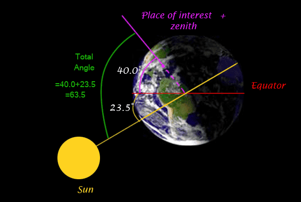

Calculate the zenith distance at noon in a location whose latitude is 40° North on Dec 22 (winter solstice)2. Homework Equations + information
I know the zenith distance is the angle between the sun and the zenith, and that during the winter solstice the northern hemisphere is "farther" (By this I mean the angle is greater) away.
See diagram:
Just want to know if I did this correctly. Thanks
Hello EzrealAsItGets. Welcome to physics forums.
Your solution looks good to me!
