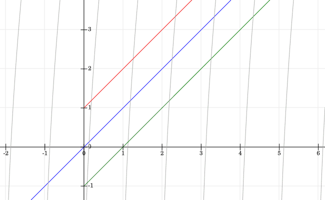

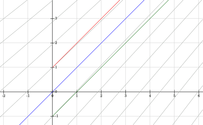

I hand't got it at first since it's not so strange that two lines on two different coordinate charts in a curved spacetime form different angles between them. I say "in a curved spacetime" because if one insists in seeing the difference, one is deliberately considering the curvature.
In the locally flat reference frame of the falling astronaut, the two paths converge very slightly (the angle between the worldlines on a spacetime chart is very small).
In the other coordinates (Schwarzschild?) the two paths diverge very slightly (the angle between the worldlines is very small).
This very small difference is ascertainable only if the approximation is not so loose as to really make the local spacetime flat. With "local" I mean any zone large enough to contain both launch events.
So the trick is that the "paradox" statement pretends it's dealing with a flat spacetime, and then poses a question that rests on such a precise distinction as to reveal that it's not exactly flat.

I think it's also worth clarifying this point. First, with respect to the original puzzle: the "cleanest" way of posing the original puzzle, I think, is the way I did in post #51: in the LIF of an astronaut falling through the horizon, a probe launched radially outward at escape velocity at some r just slightly above the horizon is moving slower than the horizon (since the horizon is moving outward at the speed of light): so how can the probe possibly escape?
The answer to this has two parts, and we can only really ignore curvature in the first part. The first part, which is what I had in mind when I first posed the puzzle, is to understand that the r coordinate is not the same as "radial distance", so the fact that the probe launched at escape velocity has a strictly increasing r coordinate from the instant it's launched is not in any way inconsistent with the fact that, within the LIF of the infalling astronaut, the probe is moving outward slower than the horizon is. (The best way I know of to visualize this is to draw lines of constant r in a spacetime diagram of the LIF: note that they are *not* straight lines.)
The second part of the answer is the calculation I did in post #51, which shows that the LIF of the infalling astronaut is much too small to allow the horizon to actually catch up with the outgoing probe. But as soon as we consider a region of spacetime larger than a single LIF, we can't ignore curvature; and of course the full answer to why the probe escapes requires us to consider curvature, since it's curvature that makes the horizon stop catching up with the outgoing probe, and then start falling away from it.
With respect to the "ruler" version of the puzzle, as I noted in post #53, if the "ruler" is to be long enough that the outgoing (escaping) probe is still below the ruler's upper end when the ruler is launched, the ruler must be about the same size as the LIF. That means the ruler will leave the LIF almost immediately. For the very short time that the ruler is within the LIF, as I noted in post #53, it is perfectly possible for the ruler's upper end to be moving outward faster than the escaping probe, so that the escaping probe moves "downward" on the ruler.
(Yes, this implies that the second ruler's upper end has an increasing r coordinate, even though its center of mass has a decreasing r coordinate, and even though, within the LIF, tidal gravity is negligible so the ruler is not being stretched. Once again, the r coordinate is *not* the same as radial distance--indeed, at and inside the horizon the r coordinate is not even timelike. But once the ruler exits the LIF, it can be stretched by tidal gravity, and probably will be; its exact behavior will depend on its material constitution and the internal forces it can sustain. But in any case, the full explanation of how the ruler's motion relative to the escaping probe changes, so the probe stops moving "downward" on the ruler and starts moving "upward" until it is completely above the ruler, once again requires taking curvature into account.)
