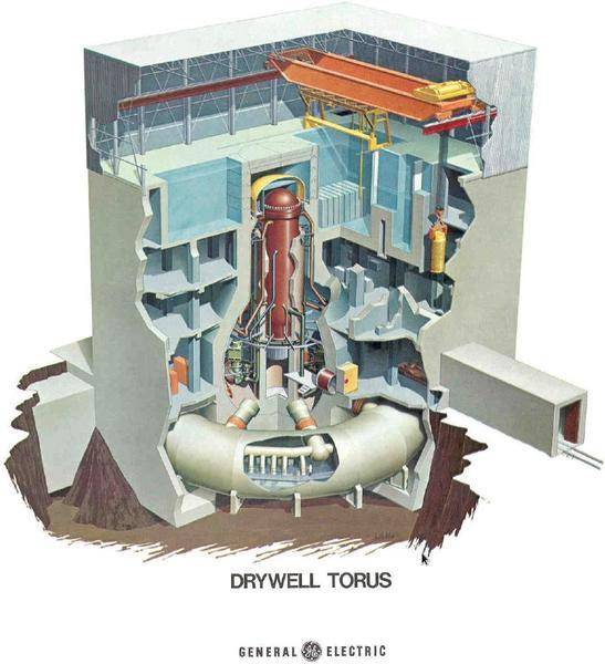

An explosion in the vicinity of the suppression pool at Fukushima Daiichi 2 just after 6:20 a.m. Japan Standard Time (5:20 p.m. EDT) may have damaged a portion of the reactor’s primary containment structure.
Pressure in the suppression pool has been reported to have decreased to ambient atmospheric pressure shortly after the blast. Plant operator Tokyo Electric Power Co. (TEPCO) has reported possible damage to the reactor’s pressure-suppression system. Radiation levels at local monitoring stations have risen but are still in flux. TEPCO has evacuated some workers from all three Fukushima reactors with the exception of approximately 50 workers involved in sea water pumping activities into the reactors as part of emergency cooling efforts.
Efforts to inject sea water into Unit 2 have been complicated by a faulty pressure relief valve. The fuel at Unit 2 has been exposed at least twice, before being re-covered with sea water.
Japan's Chief Cabinet Secretary, Yukio Edano, has said a partial defect has been found inside the containment vessel of reactor 2 at the Fukushima Daiichi nuclear power plant.

Also, they are confirming a that there is a hole in the suppression pool structure of unit-2 which is releasing radiation.
The good news is that they think that units 1&3 are effectively cool due to seawater cooling operations. Now they need to figure out how to maintain cooling.
Is the primary containment vessel strong enough to avoid being ripped apart by mere steam and pressure from the water and heating fuel rods?
The pressure is released through valves. The pressure inside the reactor vessel is below operating pressure, but about the pressure in containment, which is designed for a lower pressure at which the core normally operates. The containment is vented in order to maintain pressure below that which would damage containment.
The consequence of venting contaiment is the release of radioactive gases.
