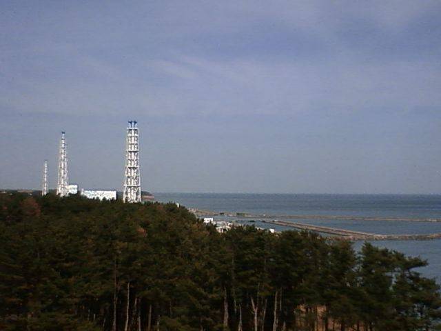

PietKuip said:
I would not exclude the possibility. The nights must be really dark in Fukushima prefecture. There are high intensities of ionizing radiation at the plant. So there should be some airglow. Maybe the dark-adapted eye can see it from a distance. Probably too faint for a video camera.
you can see the cerenkov light on the webcam pics (http://www.tepco.co.jp/nu/f1-np/camera/index-j.html only at night of course). a couple of days ago it was not directly visible, but you could make it visible with photoshop. no idea, if it grew stronger, or if the webcam is adjusted.
someone monitored the spot since march 21st:
http://www.abovetopsecret.com/forum/thread672665/pg433 (3rd post on that page)

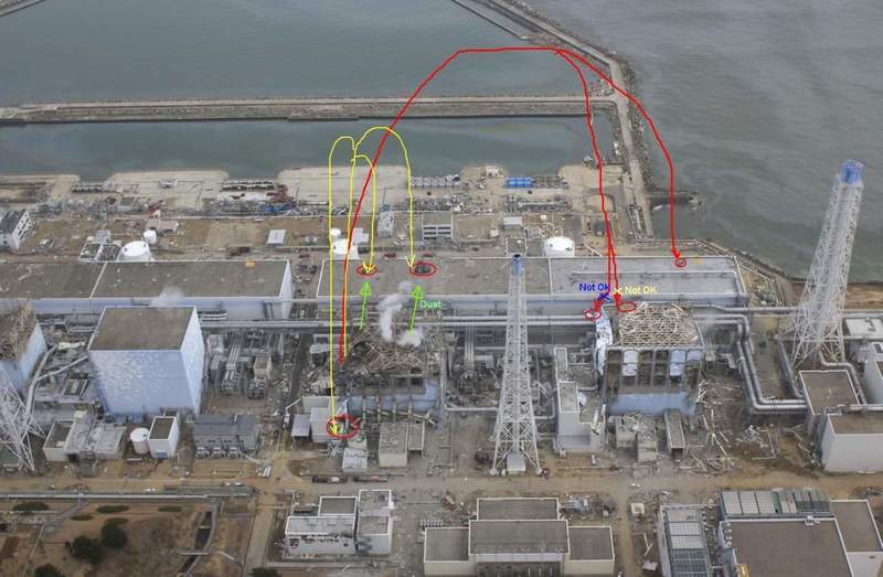

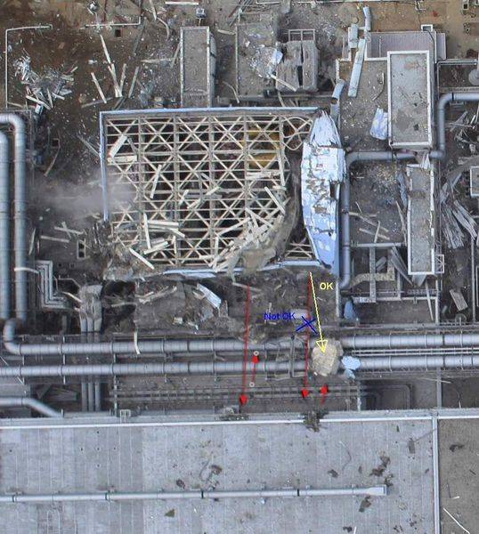

As to panel trajectories from Unit 3...
Sketches I made some time ago but didn't post are attached. These were intended as a reply to a much earlier question about the origin of an almost intact panel leaning against the building just East of the turbine building.
The specific panel in question probably was a Southmost-East facing panel from either the top or second row of panels of Unit 3.
BTW - perspective does make it difficult to judge the source...
I see why you would think that this is a wall panel from no.3 reactor building, but that is not a rf conc wall panel you have found - its the flat roof over the entrance to that small building.
I am trying to find a pre-BOOM photo of the site to illustrate this.
Found (not my image annotation, but shows the small flat roof in question)
https://lh5.googleusercontent.com/-...kk/s1600/FukushimaDaiichi-overhead+-+Copy.PNG

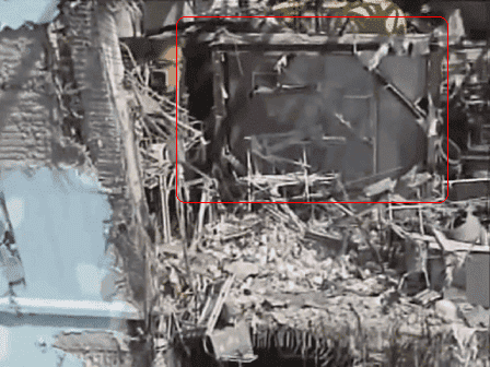

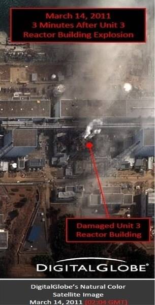

razzz said:
Why the reddish color of the debris cloud? It only last a few seconds then fads in real time.
Some of the videos were seriously contrast enhanced due to the distance shot and telephoto lens so the orange will probably be artificial. Though colour can reveal a lot about the chemistry, I suspect simple confined hydrogen explosion full of particles of concrete/dust.
This image... (or rather the second image with dust plume) though clearly shows how truly vertical that large slab is projected upwards, and that the sideways, (towards us and to the left) is purely an illusion created by the wind taking the lightweight dust to the southeast.
What explosion could project so perfectly vertically... I can only think of the concrete containment vessel again! it's the only thing shaped like the combustion chamber of a rocket. So did it fall back down on the building itself?
Sorry I'm having trouble ggrabbing the image I want from razzzz's post earlier.
watch this vid instead, the tower is directly in line with the buildings diagonal so marks the middle of the building. watch the 'slab' ...

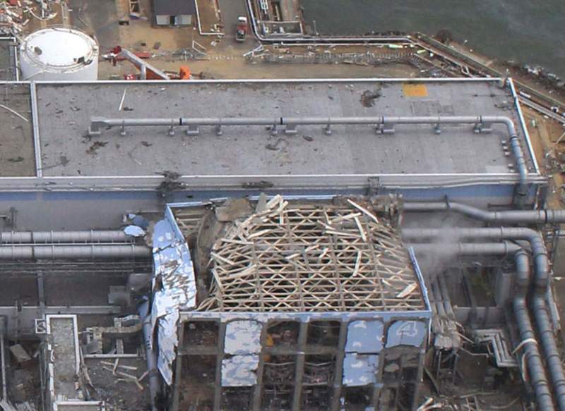

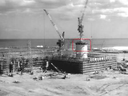

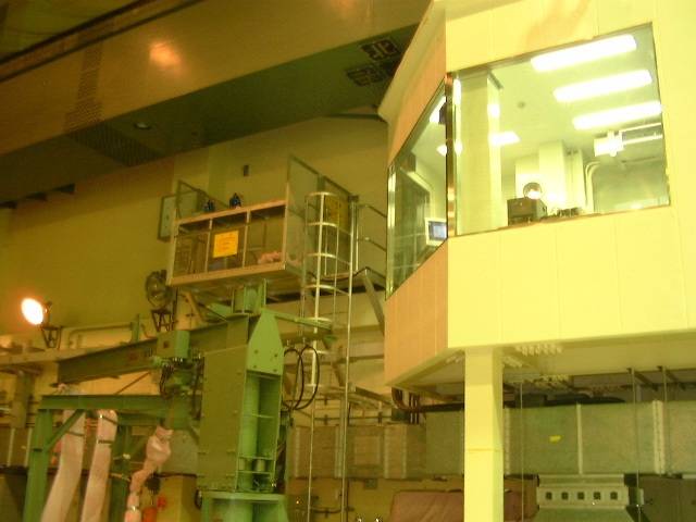

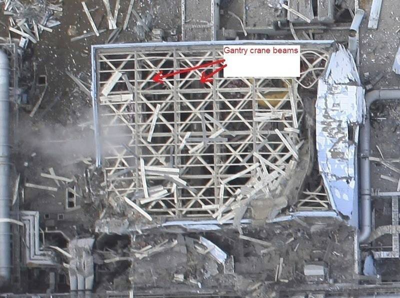

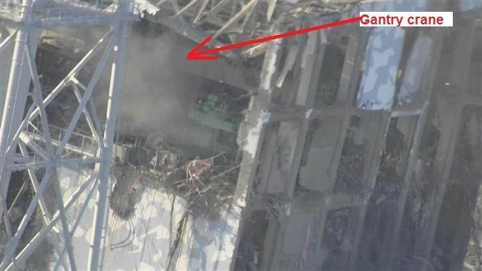

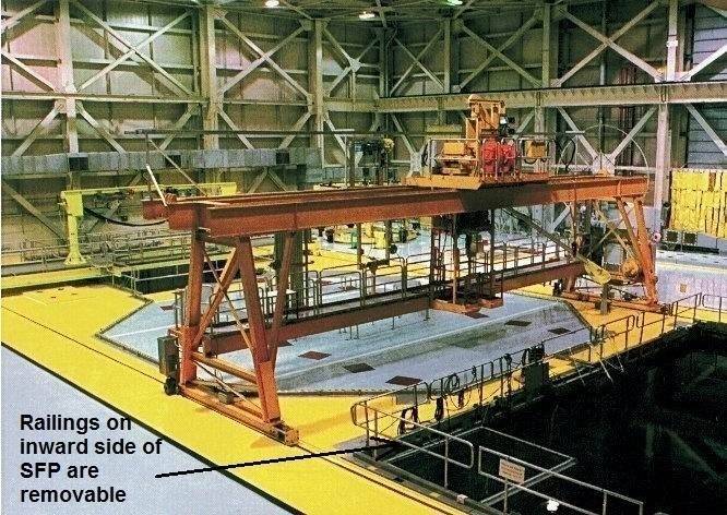

Emreth said:
That's not what I mean. There are large pieces thrown up a long way up but they might be the large sections of the trusses above the SFP that are missing, which I would expect to be much lighter than FHM. It's about the mass really. I find it more plausible that the FHM got blasted sideways in the first explosion towards the north wall, destroying the wall and itself.
Again like I said I might be wrong, no need to get defensive or dismissive.
The FHM and trusses could, I presume, be in the SFP, otherwise the NW corner for either or both is my focus. Attached are a few photos from the MOX loading of the reactor number 3, on 21 August 2010 so we know what we're looking for. More photos from the occasion at:
http://www.gyldengrisgaard.dk/20100821_daiichi03/

No worries, artax. I may well be wrong. My difficulty is that I can't match up the photographic evidence, which says:
1) vertical blast from unit 3 following a fireball at the SE corner
2) blast damage over the SE corner is over the SFP3
3) crane and roof girders are still intact and apparently on top of the location of the top plug of the primary containment
4) something that looks a lot like a heavy piece of machinery has gone almost straight up and crashed almost straight down back onto Bldg 4, which IF it is a FHM rather than the plug, then the vertical blast must come out of the SFP, not the primary containment
5) the quality and quantity of the blast at Unit 3 look fundamentally different from the blast at Unit 1 (although different construction) and the proposed hydrogen blast at Bldg 4 (same construction)
None of this excludes a blast originating in the primary containment; in fact, in my opinion, a blast did come from the primary containment, except that the blast was
1) not vertical but instead sidewise into the region of the SFP through the transfer chute.
2) associated with a secondary vertical blast coming from the SFP, and
3) possibly associated with a third blast component in the lower floors of Building 3
4) questioned because of a viable mechanism for ignition of gas within the primary containment atmosphere.
So my difficulty is correlating the pictures with a vertical blast, which all agree occurred, as coming from the mouth of the primary containment, which the photos don't seem to support, or as coming from the spent fuel pool, for which my explanation of a superheated steam blast seems to be inadequate.
Something doesn't fit -- either my interpretation of the photographic evidence (very possible) or my explanation of the etiology of a vertical steam explosion from SFP (also very possible) is wrong. So, either way, I am wrong, I suppose.
Better minds than mine are still pondering. But (sigh), I fear it may all be wasted mental gymnastics given the sum of mounting problems and the implications for the "big picture" at Fukushima.
I don't know if this is of any help to people, but I've an image that may correlate the unit 3 vertical explosion debris visible in the video to the whole Fukushima Daiichi plant layout:
https://www.physicsforums.com/attachments/34094
OK, that attachment failed :-(
How do I attach the image?

I'm like you, just want to know what happened and work out the consequences, it's just frustrating when you know they're not telling us everything.
That vertical component of the blast has me dumbfounded if the plug didn't blow.
I've searched the web for some other group or engineer that's tried to analyse the blast at unit 3, because it was enormous, and filmed from 30km away!
Seriously are you sure the plug is intact?
That large piece that comes back down on the roof, or the sw/ne axis of reactor 3 was so perfectly vertical it must have a mechanism of almost bullet/barrel like accuracy.
I can see there's no tell tale hole in the roof girders, so it does look like an SPF blast, blowing the roof off.
Anyway, hopefully they'll tell us one day!
