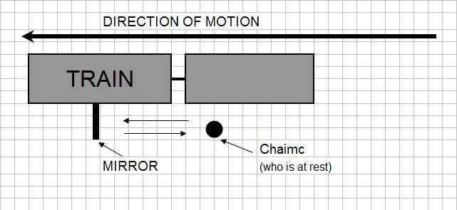

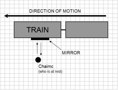

I was thinking of the scenario as;
Here are my "original" drawings (I didn't notice I can do that...):
Am I wrong somewhere along this line of thought?
Thanks again.
Thanks again.
Your last pic (y2) is not correct. When the train is stationary and the source at the side of the track is moving the light should follow a diagonal path (like an upside down 'V' pretty much like the one in the classic Einstein light clock ). In the rest frame of the train, where the signal is emitted is different to where it is received.
...and this is...:'I have given this some more thought and now I am convinced there will be no deflection of the reflection and it will not shift sideways by even by a fraction at relativistic speeds' ??
The above two statements of mine do not contradict each other, if that is what you are suggesting.
In the rest frame of the train, the light leaves the moving track side observer, travels diagonally, reflects off the train and returns diagonally to the observer who is now in a different position according to an observer on the train. In either rest frame (train or track) the signal always returns to the source. There is no shift from the point of view of the observer at the side of the track.
Maybe I wasn't too clear and I missed an important factor - I am pretending in the darwings that it is a very short burst of light, a single photon even. Does it make a difference now?
