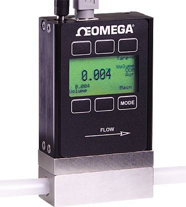

Hi,
I've got a horizontally moving piston in a pneumatic cylinder, the piston is moving backward to suck the air into the cylinder from a hole at one end, this will lead to an air flow rate. I would like to measure the air flow rate at that instant. I was thinking of with a pressure sensor attach to the cylinder, i can measure the pressure difference. By using Bernoulli's equation, i can calculate the air flow rate. Is this approach correct? and what pressure sensor would be suitable?
If you need me to explain more on the details, I would be more than happy to help you.
Thx guys.

Given that information it should be possible to get a quick answer. As the air on each side of the orifice will have a different pressure, the volume flowing will depend on the pressure where you measure it. This suggests a pressure independent mass flow meter might be appropriate.
Some light reading; http://en.wikipedia.org/wiki/Flow_measurement
Given the information though it should be possible to get an answer analytically rather than by testing. You would just need to know the things Baluncore asked for. The flow in this case is almost certainly compressible, though, so it is unlikely Bernoulli's equation will be of any use.
You can find some good gas mass flow meters here.
http://www.omega.com/subsection/mass-flow-meters.html
