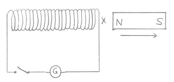

Thanks all for the explanations! Pardon me as i alternate between understanding and confusion as i read the replies. i was facing this question below. Appreciate all help. Thanks!
Q: A bar magnet is pulled away from a solenoid as shown in the diagram below.
Which of the following statements is true?
A. An e.m.f. is induced in the solenoid.
B. A magnetic north pole is induced at end X.
C. A current is induced in the solenoid.
D. The galvanometer pointer is deflected to the left.

Hello Jam Jay having seen the question and realized the level it is aimed at I am not surprised that you are confused.An emf is induced whether the circuit is open or closed so the answer is A.Answers B,Cand D can only apply if a current flows but since the coil is on open circuit there is no current.If you want to be really fussy and go beyond the level of the question you could argue that there is an extremely tiny current due to parasitic capacitance etc which others here have referred to.You could also complain that the question itself is faulty and discriminates against the more deep thinking student who realizes that there could be a tiny current.Should it be an exam question,the examiners normally brush off such complaints by stating that students were instructed to pick the most appropriate answer.
Claude the current induced here,whether it be on open or closed circuit,is dc not ac.Also, there is no current in this or any other similar system when the emf reaches a steady value.In principle a steady emf can be achieved with this system by pulling the magnet at an increasing speed such that the rate of change of flux remains constant.

I think we are at cross purposes here Claude.It is interesting to discuss what happens when the magnet passes through the coil but I wasn't referring to this ,I was referring to the question, this having the the magnet being pulled away from the coil.I agree that it is hard to get a steady emf with the system referred to in the question, that's why I stated that it can be done in principle.
The question is supposedly aimed at GCE O Levels. I guess it's suffice to give answer as A at this level? I understand that at higher level, the question itself can be questioned. Much of the later explanations are beyond me. By the way, what's mmf? Maybe it's better to change the question altogether.
