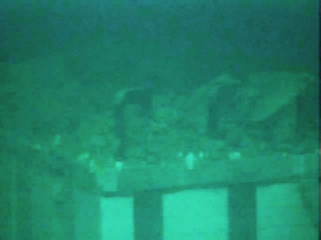

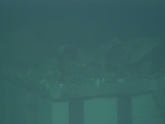

Not necessarily. If there is water in the SFP and the cask pit, the assemblies can be transferred underwater. However, if the SFP water is contaminated, i.e., if it has dissolved fission products and some fuel in it, then decontamination of the case becomes an issue. However, there is no fuel handling machine in place with which to do this work, so it would have to be done with some kind of crane based on the grounds outside of the reactor building, unless TEPCO somehow removes the debris from the reactor service floor and basically builds a new transfer system.
We still don't know the state of the fuel in the SFPs of units 1, 2 and 3. The images of SFP #3 show a lot of debris in the pool. I have not seen images from SFP of Units 1 or 2.

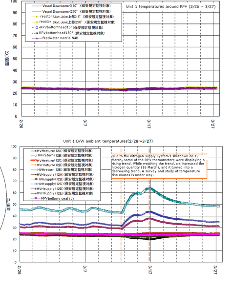

Jorge Stolfi said:
Updated my plots of Fukushima daiichi reactor parameters up to NISA release 159 (jun/04 15:30)
http://www.ic.unicamp.br/~stolfi/EXPORT/projects/fukushima/plots/cur/Main.html
I have also added some temperature data for late march taken from the TEPCO files
http://www.tepco.co.jp/nu/fukushima-np/f1/images/syusei_temp_data_1u.pdf
http://www.tepco.co.jp/nu/fukushima-np/f1/images/syusei_temp_data_2u.pdf
http://www.tepco.co.jp/nu/fukushima-np/f1/images/syusei_temp_data_3u.pdf
Unfortunately these files do not give much new data besides what i already had,
at least for that time frame. They seem to confirm that something exceptional happened to reactor #3
in the early hours of march/21, just before the black smoke event. (Thus that
black smoke does not seem to be just an ordinary chemical fire.)
Between NISA releases 158 and 159 the core presures of reactor #1 have abruptly fallen from 679 kPa and 1674 kPa to 126 kPa and 101 kPa (?), respectively:
http://www.ic.unicamp.br/~stolfi/EXPORT/projects/fukushima/plots/cur/out/plot-pres-un1-t-T-full.png
Since the other variables remained stable, it may be a transcription error (today is sunday; only a lowly trainee in the office, perhaps?), or they recalibrated the instruments and found that the previous readings were garbage.
