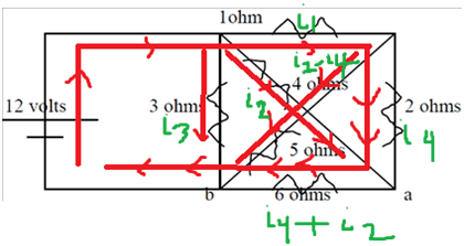

a) What is the equivalent resistance through circuit? (Answer is 1.638 ohms)
B) what is the current through the 5ohm resistor? (Answer is 1.911 amps downward)
The main part I am confuse about in part A) is what is in parallel and what part is in series because I haven't really worked with a circuit like this before.(Am I even suppose to simplify it?) For part B) I am confused about how to set up the current(like i1, i2, i3,etc). I know you can set up the current anyway you like, but if you can give me an example it will help a lot. You don't have to get the answer for me, just explain those 2 things will be fine. thanks!

Not all circuits can be simplified using the rules for resistors in parallel or series. Have you learned about Kirchoff's laws? (also known as the loop rule and junction rule)
yes I have learned about Kirchoff's laws, but I thought it would be easier to simplify it first (if possible). Like I can apply kirchhoffs laws pretty easy in 2 or 3 loop circuits, but i am having trouble in this one. Sometimes I get confused in saying where the current (I) goes, especially in a more complex circuit as shown above. I'll show you how I set up the current (I am sure this is where my mistake comes in), and hopefully you can lead me to the right direction. Ill post in about 5mins. thanks though for quick response
I don't know if you can read it
3OHM = I-3 downward
1OHM = I-1 to the right
4OHM = I-2 downward
2OHM = I-4 downward
6OHM = I-4 + I-2 to the left
5OHM = (I-1) - (I-4) downward
Got it. What will be your label for the current flowing through the battery? (Remember that when applying Kirchoff's laws, you need to label all segments of wire with their currents)
Once you figure that out, try writing the loop laws. Since this is a slightly complicated circuit, you might first want to think about how many loops (and thus how many equations) there will be, before you spend time figuring out what they are.
flowing through the battery looks like (I-1) + (I-2) + (I-3). And I think I will need 4 equations. I think I've tried it doing it like this before, but I'll try it again (maybe I made a mistake somewhere)

edit: also is the 5OHM resistor (I-1) - (I-4) downward or (I-1) - (I-4) + (I-2)downward, cause it looks like I-2 gets added in? not sure about this
and will i have to use the flow through the battery anywhere in the equations? (I've never really used the I's without a resistor before that's why i left it blank)

Makes sense. You might not need the current flowing through the battery, but it's good to label it for consistency.

If you show your work, we can help you see if you've done something wrong.
figured it out, tried a different way, thanks diazona
