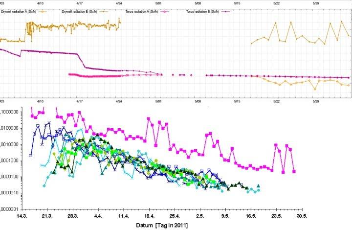

AntonL said:
But are they out of order? or is there something happening in the reactor that we are not supposed to know or deduce from their data, now look at the temperature plot, on the same day 8th April there was a sudden spike coinciding with the spike of the CAMS data
Could it be ... that the sudden spike of temperature on April 8th is somehow related to the nitrogen operation?
April 6th 22:30 Started the operation for the injection of nitrogen to PCV.
April 7th 01:31 Confirmed starting the injection of nitrogen to PCV.
http://www.nisa.meti.go.jp/english/files/en20110504-1-2.pdf
Also by some strange coincidence this nitrogen operation might have messed with CAMS drywell?
  • #6,312
elektrownik said:
OMFG did you saw CAMS data 3/14 for unit 3 ? It is error or 100% of unit 1 core is damaged
pdObq said:
You mean unit 1? Did you see D/W value for 4/8 ?
added: Does anyone have an idea at what level those sensors saturate or get damaged?
~kujala~ said:
pdObq, it's better to look the overall trend, not some big values every here and now.
For the unit 1 it mostly makes sense until April 7th 18:00 (31,1 Sv/h), then you suddenly get these mega values after which CAMS D/W(A) stops working.
I wouldn't trust the values between April 8th 0:00 - April 8th 13:00 for the unit 1.
pdObq said:
Hmmm, the sudden high readings at 4/8 coincide with the sudden temperature rise of that N4B sensor (sorry, too lazy to put the japanese label into google translate). The other temp. sensors seem not to see that.
AntonL said:
Now note that spike in Unit 1, and Tepco refrained from publishing any more D/W CAMS data after that event, their reports mention that the unit 1 D/W Cams is out of order, both of them the A and B channels
I leave it for the experts to comment, was there a sudden small sub-critical event on the 8th April?
[PLAIN]http://k.min.us/in4JQ0.JPG
I was not able to copy and past the Japanese sensor labels into Google Translate (pdf document does not allow copying [sure, there might be tricks..]), but awesomely enough Google Translate eats the whole pdf file and spits out translations for all sensor labels.
Wow, I am amazed... (even if the images are lost and the format gets screwed up)
http://translate.google.com/translate?js=n&prev=_t&hl=en&ie=UTF-8&layout=2&eotf=1&sl=ja&tl=en&u=http%3A%2F%2Fk.min.us%2FilskVG.pdf
The N4B sensor translates as "Water nozzle N4B (end)". But still what does N4B stand for? Just some label on some schematic that we don't have? There is also some N4C on page two of the document. (Btw, those documents are awesome! Thanks AntonL!).

  • #6,316
Oh, google comes up with some stuff for "feedwater nozzle n4b".
These are just the first two documents with drawings and stuff, which I don't have time to digest now:
Oyster Creek: http://pbadupws.nrc.gov/docs/ML0819/ML081900084.pdf
Clinton: http://pbadupws.nrc.gov/docs/ML1103/ML110320387.pdf
Quote from the first one: "There are four feedwater nozzles in the system (N4A, N4B, N4C, and N4D)."
From the second one (p.11f) it seems that all the openings of the RPV (they call the N ones nozzle-to-shell-welds it seems) have such labels.
