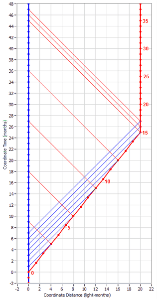

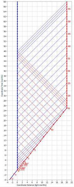

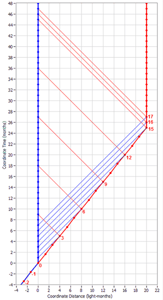

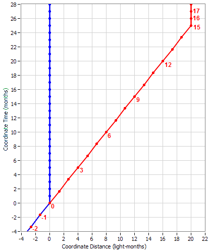

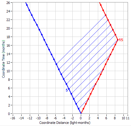

With your indulgence, I'm going to modify your scenario slightly. Instead of Bob landing after 2 years (or 24 months), I'm going to have him land one month later at 25 months. This makes the calculations come out a lot cleaner.
Here is a spacetime diagram depicting your scenario. Alan's progress is shown with the thick blue line and Bob's progress is shown with the thick red line. The dots show one-month increments of time for each twin. I start in an IRF with both twins traveling at 0.8c. At the Coordinate Time of 0, Alan comes to a stop while Bob continues on until the Coordinate Time of 25 months when he stops. Note that at the very beginning of the scenario in the lower left corner, both Alan (blue) and Bob (red) are colocated so I show a blue line with red dots:
wildsman said:
If I pick Alan as the IRF, both twins start off stationary (if they are at the same velocity). When Alan slows down to a stop, it would seem like Bob is moving away faster. Thus, because of time dilation, Bob's clock looks like it has slowed down. Then, finally after two years, when Bob lands he has already gained a head start (so to speak) of .8 years. So, Alan is .8 years older than Bob by the end.

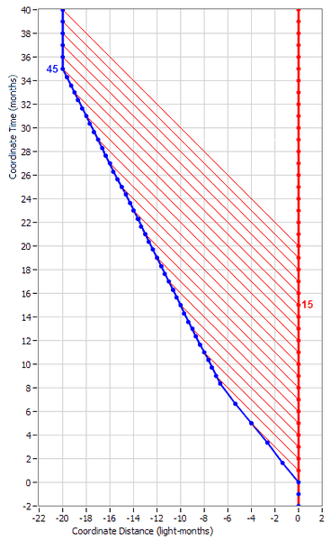

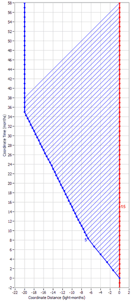

You should say, "If I pick Alan as the non-IRF (or non-inertial reference frame), then both twins start off stationary..." That part is easy, the rest of the scenario has to be measured and calculated by Alan, he just can't know magically what is happening to Bob in order to construct his non-IRF and there is no standard way to make a non-IRF like there is in SR to make an IRF. My favorite way is to use the radar method with Doppler observations which actually works identically to the standard way in SR for IRF's as you'll soon see.
In the radar method, Alan sends out radar signals that travel at the speed of light and reflect off Bob. At the moment of reflection, the image of Bob's clock is transmitted back to Alan along with the radar reflection. Alan notes the time according to his clock when he sent the radar signal and when he received it. Then he applies Einstein's second postulate that the signal took the same time to propagate to Bob as it did to reflect back to him. This allows him to assign the moment of the reflection as the average of the sent and received times. He can also calculate the distance to Bob at that moment as one-half the difference in the times (we are using units where c=1). Then Alan builds up a table showing his measurements and calculated results. Here is a diagram in the original IRF showing his sent radar signals as thin blue lines and the reflected and Doppler signals as thin red lines:
And here is the table showing his measurements and calculations:
Code:
Radar   Radar   Calculated   Calculated    Red's
Sent    Rcvd      Time        Distance     Time
 -2      -2       -2             0          -2
 -1      -1       -1             0          -1
  0       0        0             0           0
  1       9        5             4           3
  2      18       10             8           6
  3      27       15            12           9
  4      36       20            16          12
  5      45       25            20          15
  6      46       26            20          16
  7      47       27            20          17

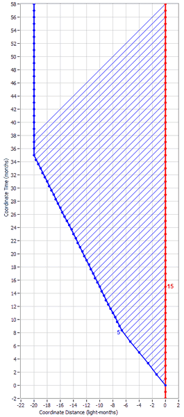

Now from the data in the table, Alan can construct a spacetime diagram showing his non-IRF including his radar signals, reflections and superimposed Doppler signals:
As I mentioned before, this IRF looks exactly like the IRF of the first diagram (with the exception of the period prior to his stopping). Your analysis of how Alan observes Bob is correct, except that I have modified the time difference to be 10 months instead of 0.8 years (which is 9.6 months).

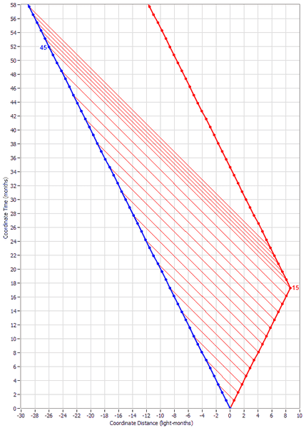

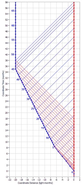

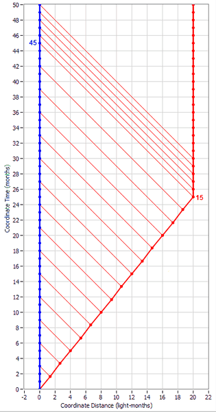

Yes, you did make a mistake. You assumed (without doing any measurements or calculations) that Bob would see Alan's clock ticking slower than his own for the entire two-years of Coordinate Time (actually 25 months in my modification). But let's see what happens if Bob does exactly what Alan did to make those measurements and calculations. First we look back at the original IRF with the radar and Doppler signals that Bob sends and observes. Now Bob is sending out the red signals and observing the blue signals:
Here is the table that Bob makes:

And here is the diagram that Bob constructs:
Now I think you can see that your assumption that the Time Dilation that Bob determines of Alan's clock does not apply for the entire 25-month interval but only for the first 5 months of Alan's time or just over 8 months of Coordinate Time and Bob's time. After that, he will determine in his non-IRF that Alan's clock is ticking more rapidly than his own or that of the Coordinate Time (which are the same), the net result being that at the end, Alan's clock is 10 months ahead of Bob's clock, just like in all the other reference frames that we have considered in this post.
Does this all make sense to you? Does it answer all your questions?
Thus, because of time dilation, Alan's clock should look slowed down.
As I pointed out in the previous post, Time Dilation is something that an observer can determine by sending radar signals, making measurements and observations, assuming the propagation time is the same for the outgoing radar signals as it is for their echoes, and then doing a bunch of calculations. Time Dilation is different in different reference frames but what each observer sees of the other ones clock slowing down does not depend on the different reference frames and that is what I want to show you now. This is the subject of relativistic Doppler in case you want to do some more reading about it.
I want to go back to the original reference frame that you've seen over and over again, except this time I want to show you what each twin actually sees. We'll start with what Alan sees of Bob's clock:
Note that Alan (in blue) sees Bob's clock running at 1/3 the rate of his own clock up until his clock reaches 45 months (and he sees Bob's clock at 15 months). After that, Alan sees Bob's clock running at the same rate as his own, just always at 30 months earlier than his own.
Now let's see how Bob views Alan's clock in the same reference frame:
Note that Bob (in red) sees Alan's clock also running at 1/3 the rate of his own clock even though it is Bob's clock that is Time Dilated in this reference frame. Unlike Alan, Bob only sees a difference in their two clocks up until his clock reaches 15 months (and he sees Alan's clock at 5 months). After that, Bob sees Alan's clock running at the same rate as his own, just always 10 months earlier than his own.
Even in Bob's non-IRF, we will note that both twins will see the same thing. Here's Bob's non-IRF showing what Alan sees of Bob's clock:
This shows that Alan again sees Bob's clock running at 1/3 the rate of his own for 45 months and then at the same rate.
Next we look at how Bob sees Alan's clock running in his own non-IRF:
This also shows the same results as Alan's IRF.
Now I want to use the Lorentz Transformation process on Alan's IRF to see what the scenario looks like in a frame where both twins are traveling at the same speed, 0.5c:
Again, even though both twins' clocks are Time Dilated to the same extent in this IRF, Alan still sees Bob's clock running at 1/3 of his own up to 45 months.
And the same IRF shows what Bob sees of Alan's clock:
And Bob still sees Alan's clock running at 1/3 of his own for the first 15 months and then the same thereafter.
