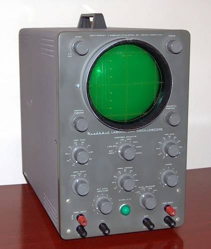

Some day I'm going to try and find a replacement power transformer for my old Heathkit Oscilloscope.

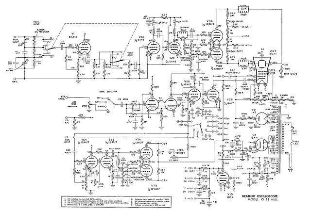

I'm hoping Xyius doesn't see this as highjacking his thread but as an oscilloscope problem solver thread. :smile:
dlgoff, are there any semiconductors in that scope? By the looks of it that isn't a real fast scope with no BNC connectors for inputs. Here is a scope that I have: http://www.oldtestequipmentarchives.com/item.htm?item=77
I believe it has ONE semiconductor diode in it. The rest tubes. Pretty basic unit and certainly not very fast.
I don't think there are even any diodes in this old scope. Here's a schematic of it but I'll need to get it out of storage to make sure it's the correct model.
